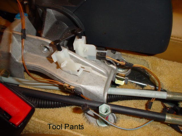

Does the red light on your instrument panel illuminate when you engage the brake? If not, then it is a common prob (had mine fixed recently). There is a small microswitch that is triggered when you engage the brake and that illuminates the PARK on the instument panel when engaged and the top needs that to happen for it to open prperly.
Troubleshoot this first. After that, threre are a couple other options.
This is a common problem with the Boxster. Did not know the 996 had the same issue. Start the car and pull up on the lever. If the warning light does not come on then it is the switch.
There is a $5 switch on the brake lever that needs to be replaced. A better switch has come out. Have to remove the center console like you were going to do a B&M install.
To get you going pull up and down on the lever a bunch of times and you might improve the electrical contact.

The switch takes a minute to replace - once you have removed the center console. B&M has good instructions on how to remove the console - it is just 7 screws. Loren may have the instruction on this site. If not someone will give you a link or email them. The link I have is old and not working.
