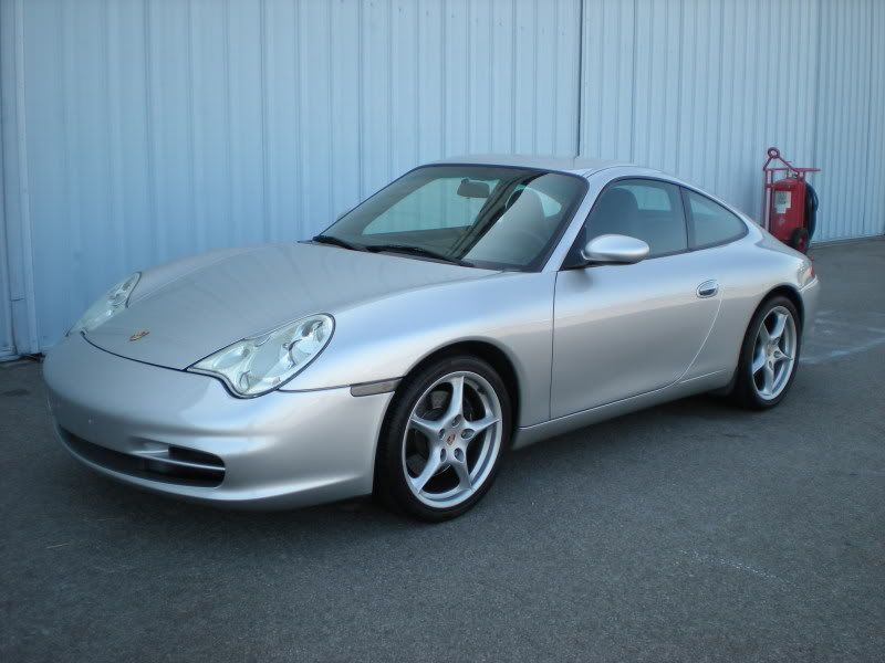

Well thanks for all the great info guys. I have entered the world of Porsche ownership today. I bought a 2003 911 C2 with 41,000 miles for $29,000. It has a porsche service history and I am now the 3rd owner. It is absolutly immacluate condition. Just needs 2 front tires ( rears were replaced very reciently). I am very mechanically minded and have maintained all my own vehicles and am planning to do the same with this car. I am very lucky to have found this form as there is some awsome maintance info and tips here.
My next question should I buy some type of warranty. I never have done this in the past, but i could not manage a major repair as I`m now tapped out.
Thanks in advance for all your advice.
Congratulations on your new P car, Looks great! But most importantly, I hope it drives great! As far as the warranty, check other threads about buying warranties. It seems that the best and most comprehensive ( and probably most expensive) are the warranties that the Porsche dealers recommend. Some will limit the claim to a specific amount ( say $3K for an engine failure, which would cost upwards $14K) and some will warranty the entire job. ALways check the fine print, and do not rely on what the salesman tells you. You can expect to pay $2-4K for 24 to 48 months.
Very nice purchase, I'm so envious. I'm in the same market for the same type of car in the southeast. I'm also debating whether to buy a C2 now, or wait and save that bit extra for the C4. You did very well to find a good mileage and low number of owners, with the history.
Smart choice... I also picked up a C2 2003 coupe with 12,200 miles... I preferred less moving parts and less drive-train joints and boots to wear out and need attention. Also, you got the better 996 engine! Enjoy!
