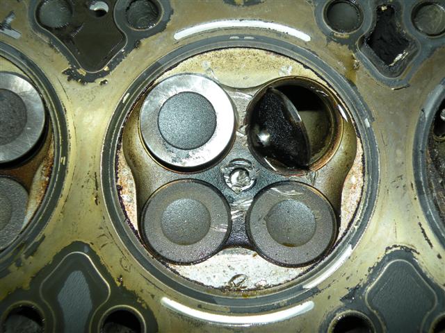

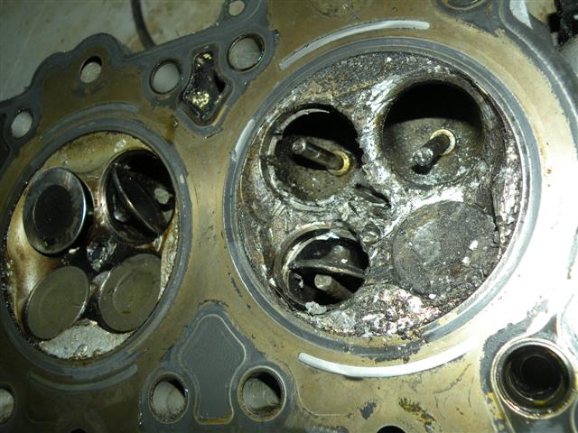

Porsche designs the very best in performance with extended oil change intervals for a reason...they are the SME's in this case (Subject Matter Experts).
Those guys are really, really good.
And these components LOVED those extended drain intervals!
The true Pinnacle of development!
Edited by Jake Raby
Nice, sharp photos that clearly illustrate some of the shortcomings of these engines that have been the topic of much debate here and on other forums!
They certainly serve to bolster some of the contentions contained in the December 2008 Excellence article!
Regards, Maurice.

Obviously those guys (Porsche) are really good or we wouldn't spend the money we do and you would bother rebuilding the engines.
That being said, what root cause data shows that all of the failures in the pictures above are lubrication related and not the litany of issues that can cause engine failure. The first set of pictures looks like a valve connected TDC. That can be octane, retarded timing, timing chain failure, etc...

That being said, what root cause data shows that all of the failures in the pictures above are lubrication related and not the litany of other issues that can cause engine failure. The first set of pictures looks like a valve connected TDC. Other pictures show resulting piston wall scarring (post valve failure). That can be octane, retarded timing, timing chain failure, fatigue failure not lubrication related, overheating, etc...
I'm simply trying to understand how a spin-on that does not have the filtration rating of a factory filter is the panacea for these failures. I don't get it. Having spent the past decade in the oil business, I have provided consistent oil sampling for a variety of applications. I have not found it necessary to provide more frequent oil changes than Porsche recommends. As a matter of fact, the last sampling I did at 14K told me I had 6K left before sampling again. I change my oil at 15K.
I absolutely respect your talent with the Porsche Flat 6 engines, however, I would like to understand the failure analysis and how the conclusion is lubrication related. There are many opinions, and I have read an article or two, but an article is simply one person's opinion on a topic. I like to get multiple SME input and link some correlation to a data driven analysis. Without data, it's simple an opinion...
Are you suggesting early IMS failures are lubrication related and not an inherent flaw to initial go-to-market design flaws?
Just trying to better understand. Good edification.

Not al the failures illustrated here are lubrication related..
They all share one thing in common...
The same SMEs did the design work.
Trust me. I have data, almost 5 years of it... Including no less than 75 oil samples and data from my intellistick in two different test cars, along with data from 11 different major oils and 5 different spin on filters.
I gathered all of this during the development of my engine program.. Its something that I share with my clients who purchase an engine, but there is no need to post it, as all it does is breed conflict.
I test components and processes all day long.. Thats all I do, with an occasional engine assembly. On site I have two engine dyno labs, chassis dyno as well as two different data logging systems... B etween all of this I have over 100 channels of data acquisition... We don';t just bolt things on and send them down the road, I have a VERY thorough understanding of anything that leaves here with my name stamped onto it.
