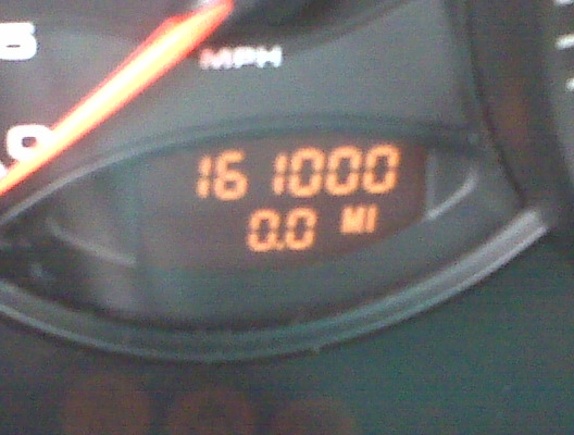

My 996 with almost 160,000 miles on it

just went over 160,000 miles and the ignition works fine now. i almost took it apart to replace the ignition. but as i was taking the left vent off, the wheel locked and i wiggled the wheel while it was locked and heard a click. and i retired to start the car and started fine. put the vent back together and has been working fine since.
lets see how long it will last.
