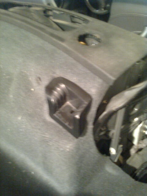

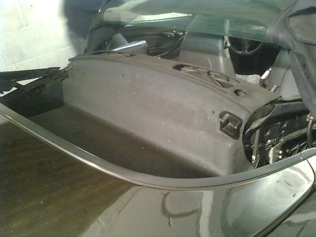

Dear all,
hello from Belgium.
recent owner of a 1998 carrera 996, also encountering the cab top problem.
having read this super helpful DIY and all your comments, I'm also attempting to do the same.
But I don't succeed to take the carpet off, mainly due to the 2 hard plastic bits on left and right on the vertical (please refer to the attached pictures)
the carpet goes around them and I don't see how I can take the carpet out without damaging the carpet in order to get it through them.
Please if you can share with me how to solve this problem it is much appreciated.
Thank you all in advance.
Stephen
post-68165-0-51408400-1302549965_thumb.j
post-68165-0-75839700-1302550316_thumb.j
I had the same problem and after getting some help from the forum and reading the DIY, I have successfully added hydraulic fluid to the system and it works perfectly. I am by no means mechanically inclined. If I can do this work, anyone can. I purchased the porsche hydraulic fluid from suncoast. The most challenging part of this fix is the small space available and the small opening to add more hydraulic fluid. I recommend using a small syringe and go to any auto parts store and purchase a small amount of flexible rubber tubing. The diameter must be small since the opening where you put the fluid is very tiny. Good luck!
