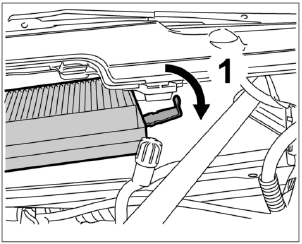

1. Remove battery cover.
2. Remove cover on right for plenum chamber.
3. Open the lock 1 on the filter housing.

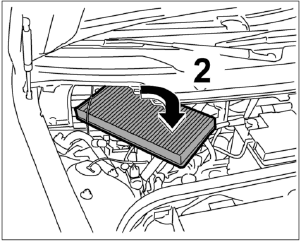

4. Remove the particle filter upwards and to the side 2 out of the housing guide.
Installation is the reverse.
