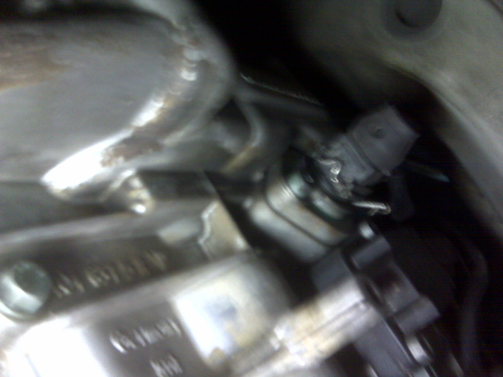

Okay I found where the fuel is coming from but there is no way I can get to it. It's not the injector... It's coming from the area above the injector in the photo. I can't see the actual source..
Its squirting a lot a fuel when I turn on the ignition so I guess it could be the plugged return line. I cant see it or get to it. I only know the area it's coming from. Any suggestions? Does the engine have to be dropped to get to it? :huh:

I think I found the problem but I can't do anything about it. It appears the plugged return fuel line form the 3.4 set up is the culprit. Is the line about 1/2 inch in diameter and runs parallel to the injectors about 4 inches above them? This is what is leaking but I can't get to it. Even if I could i wouldn't know how to re- plug it.
