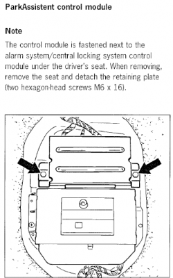

The parkassist control unit is plugged into the side of the central locking/alarm control unit.
I believe the alarm control on a RHD car is under the passenger seat.

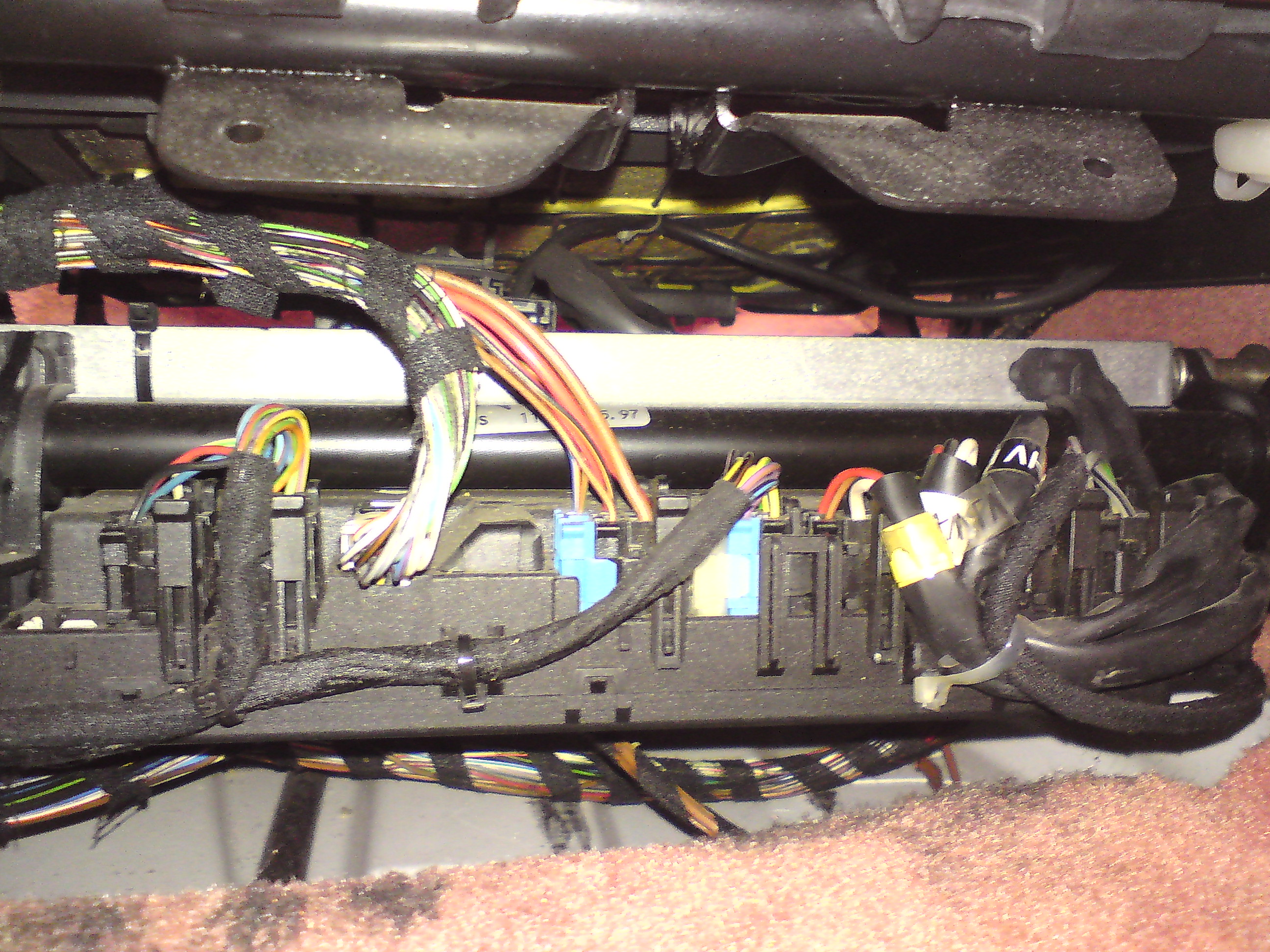

On my car, I couldn't find the control units like those pictured. Instead, I have attached a picture of an array of connectors into what seems like a single black plastic ecu unit. Actually, it's so small I don't know if it really is an ecu or just a connector box.
I have unplugged my sensors at the bumper-side, and now the speaker emits a constant tone whenever reverse is engaged (which is expected). What I would like to do is to disable the sound and/or ecu (I want to disable the park assist sensors).
