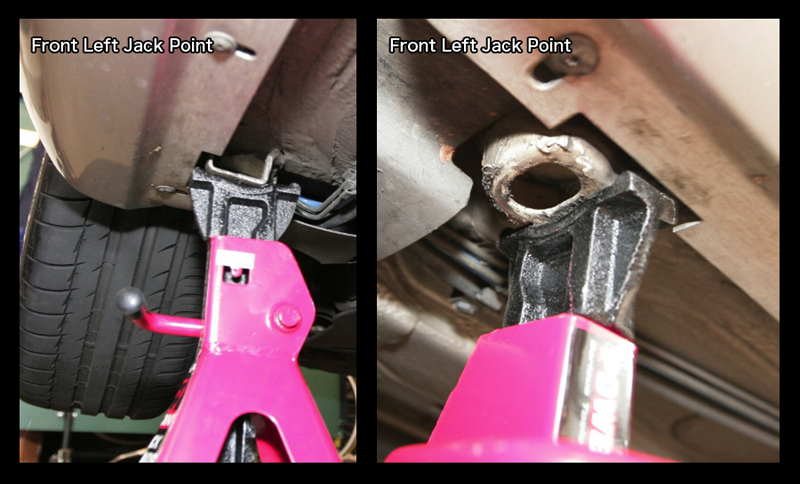

Hi all,
I will be replacing pads and rotors for the front end. I will perform one wheel at a time and I wonder if that is a safe idea, or should I jack up the whole front to work on both wheel at a time? Attached some photos where I jacked the car up at the left rear jacking point, and a jack stand at the left front point. Do these look safe to you? Especially the placement of the jack stand.
thanks,
Andy

Hi Loren, I have that downloaded and read through the whole thing. My question though is if it's safe to do just one wheel at a time since if so, the jack stand tends to be off-centered (photo). Any thoughts? Thanks.
Andy
No, always get the jack stands centered as you could bump the car and it could fall.
I like to leave the jack and/or a wheel under the car where I am working just in case.

Hi Loren, thanks for your advice. I will make certain that I leave the jack attached as well.
