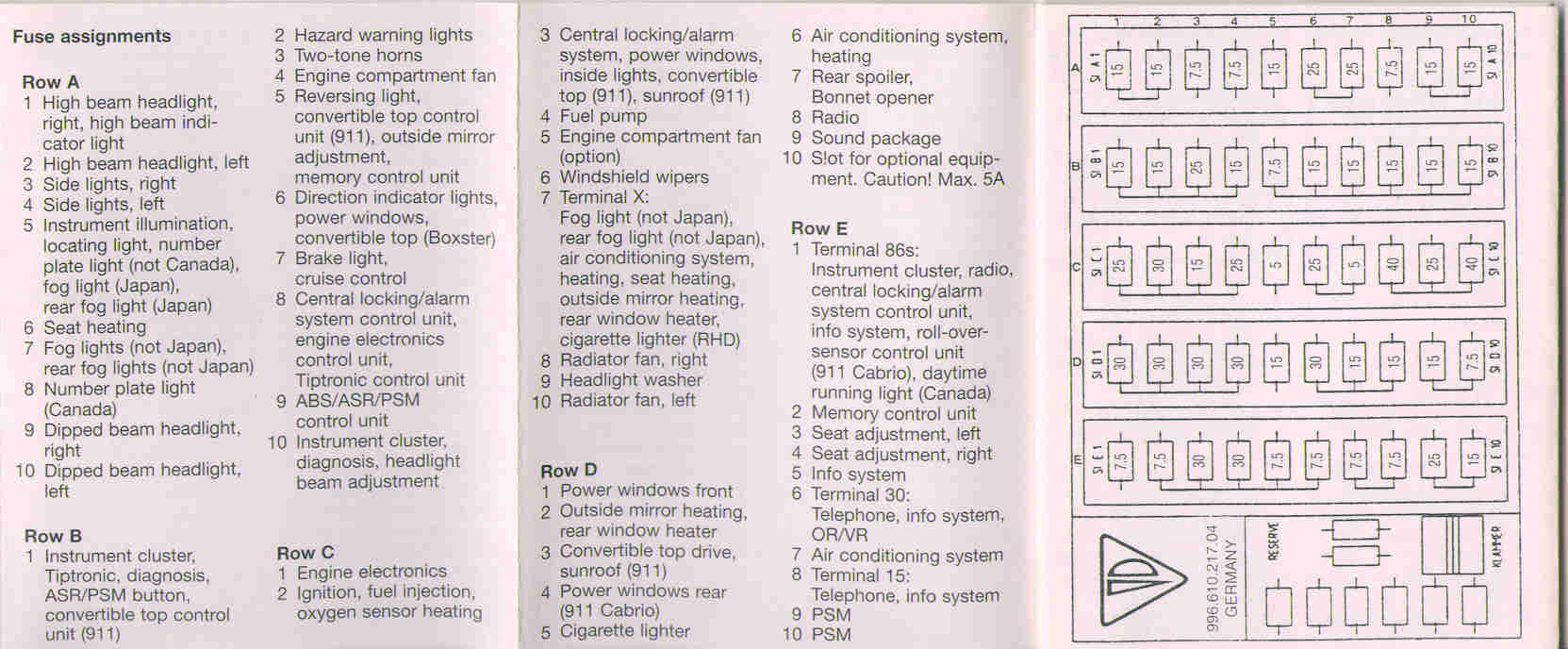

Now with the meter in place pull one fuse at a time and check the meter readings - do this until you find which circuit is drawing the power - then you will need to determine which component on that circuit is drawing it.

If it isn't the detector, you are going to have a much more complex process to diagnose by having the battery tested...by measuring the current draw while one fuse at a time is removed to see what circuit is creating the draw.

You could put a volt meter on the battery and start pulling CB's (Sorry Fuses). When you notice that there isn't a draw with a particular circuit breaker you have found the source. Then find the fault within that circuit. Easy if you have a helper.
