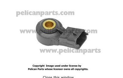

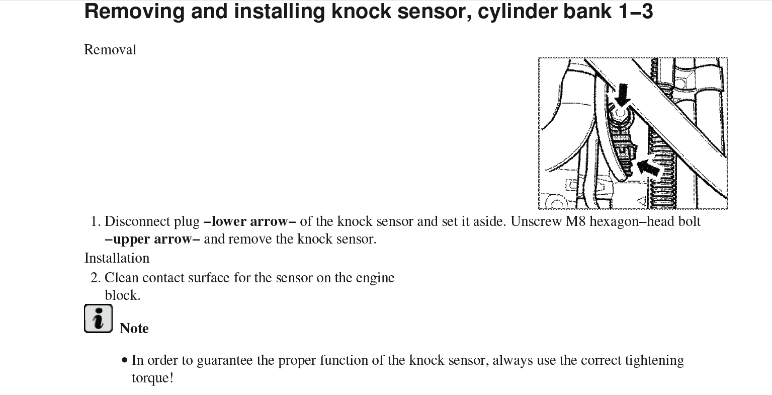

First the repair manual is only talking about sensor removal/installation with the engine removed. I don't have any experience with this but the driver side one look easier to removed. The part# is 996-606-125-00 and it is about $79.00.

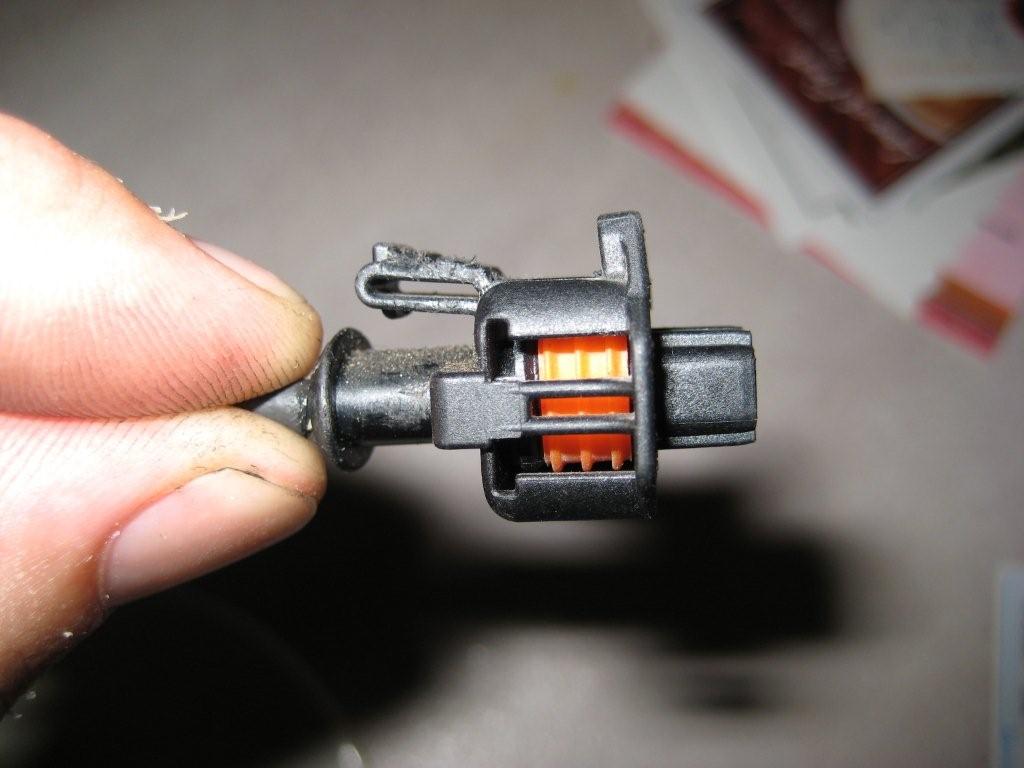

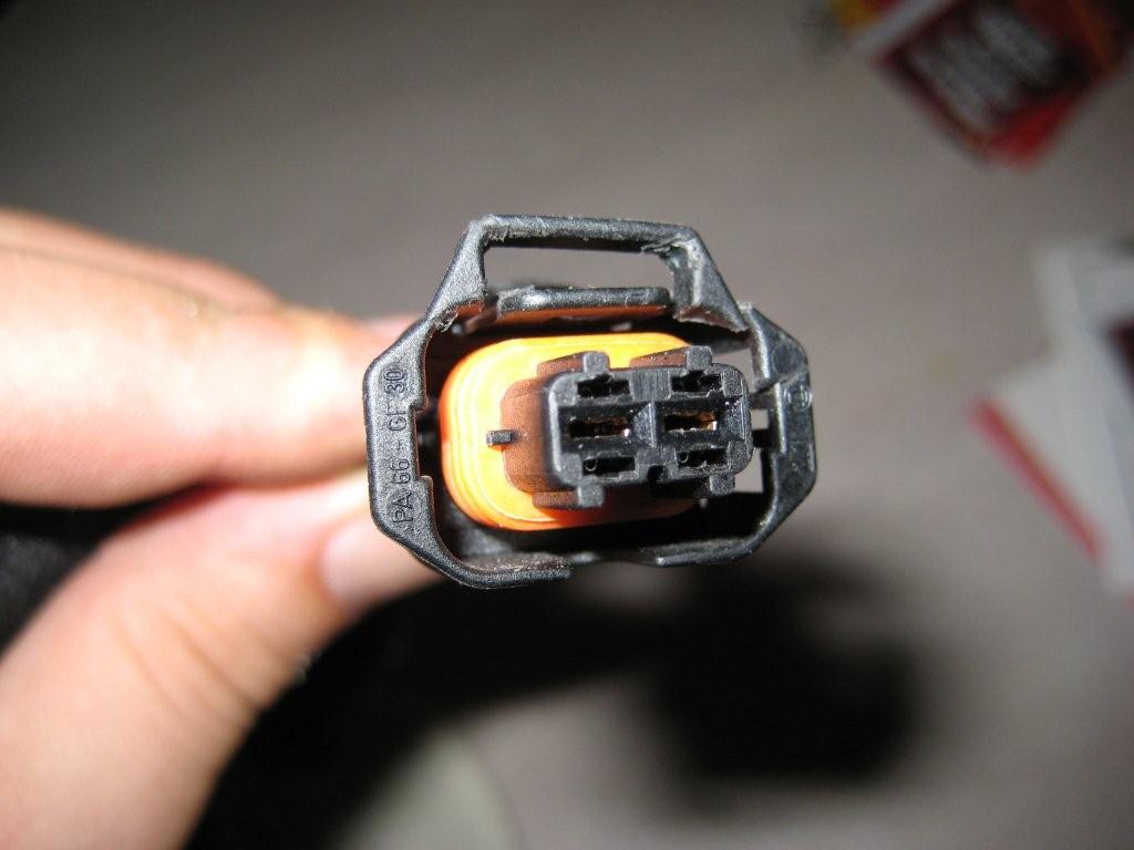

thanks for the pics they were a big help, and sure as hell the harness that plugs into the knock sensor was all chewed up. No nest or droppings but the bugger chewed the end off right at the connector and now I need a new connector that has a short length of wire on it so I can patch into the cars harness. Do you know if that connector is commonly used in other electrical connections (like O2 sensor or crossreference numbers with vw cars, so I can cut of the sensor and just use plug) or if you can just get the plug any kind of info would be great thanks.
thanks guys but a local vw dealer helped me out big time. They removed the old wiring without destroying the original plug and matched up the original wire and made the plug like new again. Porsche said too bad so sad $200 for new harness just to use only the small plug. They also said the motor has to come down no other way to access it. Its impossible. So I guess I did the impossible and again recieved no help from my local dealer. But thank all of you for your help this website is such a great resource
