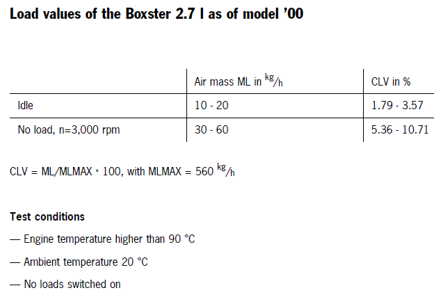

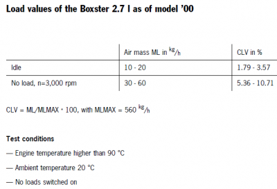

Took an OBDII to USB reader plugged in my laptop computer, Using a freeware, I did look to MAF readings. Here they are: At idle, motor hot (183F coolant), reading goes between 2.75 g/s (9.9 kg/h) & 3.0 g/s (10.8 kg/h) and at 2500 RPM, no load, between 9 g/s (32.4 kg/h) & 9.75 g/s (35.1 kg/h).
Are those readings correct?
