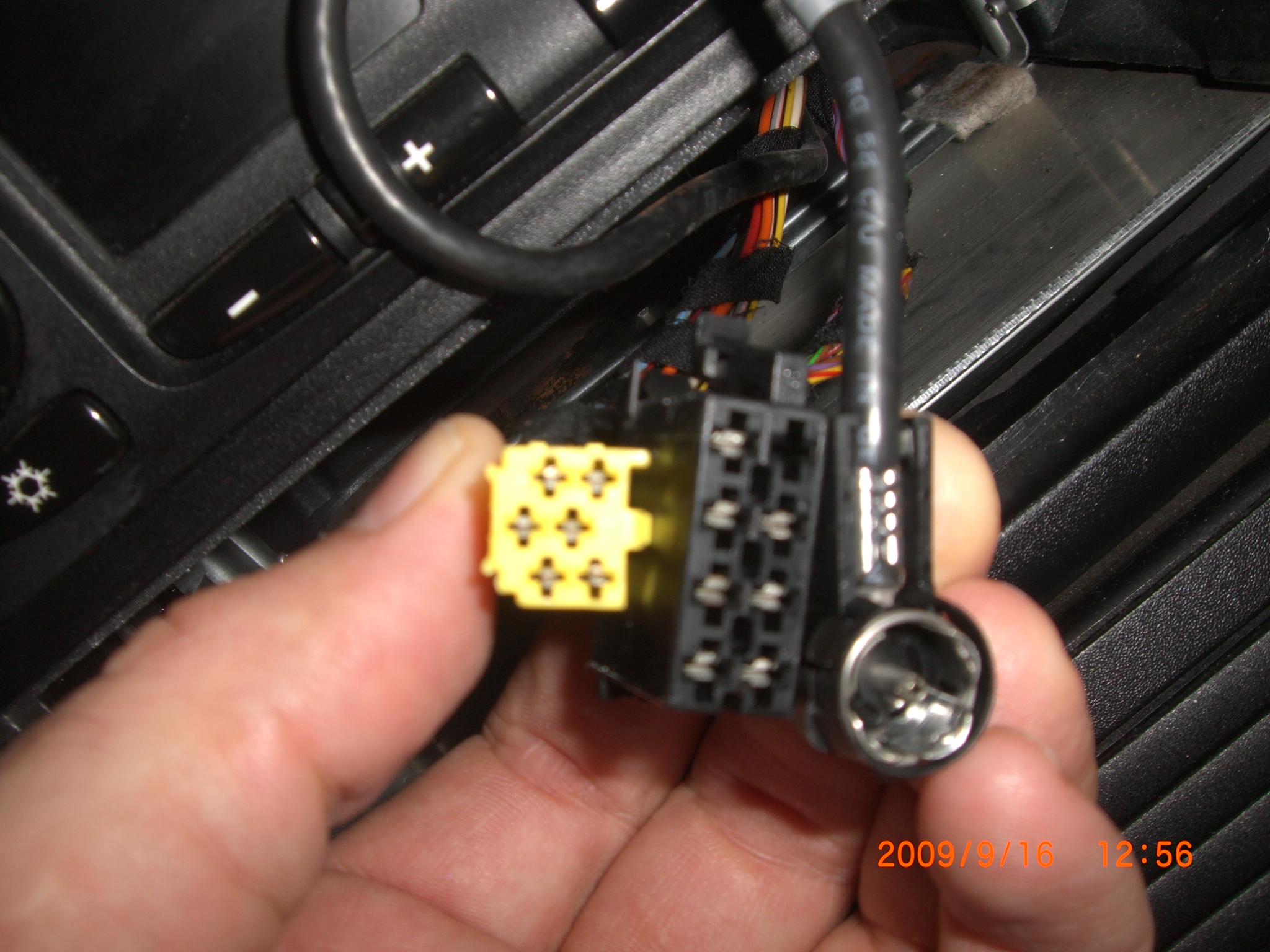

Hi,
I tried to do a search on this subject, but I could not find any help. I'm changing my CDR-220 to a JVC unit. I found the one I liked at Best Buy, but they did not have any wire kits for me. I tried Mobile One too ,but they didn't make them either.
Is there a wire kit that I can use with my car for an easy installation? If I have to manually do all the wires separately, how hard is it?

I replaced the Becker unit in my '01 Boxster S a year or so ago and I used a harness I ordered from Crutchfield that was for an Audi and worked perfectly. I forget exactly where I found the link to that particular harness. I did have to switch a few of the pins in the harness to get my rear speakers to work IIRC, but that was an add-on for the Boxster anyway. Your '99 C4 should be identical to my Box. If I can find the link to the harness I'll post it. Try searching the archives at PPBB.com I might have gotten it there.

When you goto the Crutchfield website you have to specify exactly what year, make model and what options you have and they will get you the right harness. I had to choose "No navigation system" "with door speakers" .

gchu, the 2002 Bose is special. I just replaced the CDR200 in my 2002. I assume you're keeping the Bose amp and speakers, since otherwise you're starting from scratch.
To adapt an aftermarket head unit to the 2002 Bose amp, you start with the Crutchfield harness and...
1) Pull out and discard the RCA plugs/wires/pins from the red connector . The only wire that matters in the red connector is the blue one.
2) See the four greyish whitish wires in the black connector? Those are the speaker level wires and the Crutchfield connector only comes with four pins/wires (and four empty slots), so you need four more. The guys who sell the kit for Porsches here (Euromotorspeed) DO NOT include the appropriate wiring, they just provide the same Audi harness as Crutchfield. A fun discovery once everything is disassembled on a table :o . Not sure if the right sized pins are an off the shelf item so you could make your own.
3) Connect the new head unit's eight speaker wires (four channels x + and - ) to the eight wires in 2 above. Ignore any line level or subwoofer outputs on your head unit--the Bose amp manages all that stuff from just the four channel input.
4) Connect all the other wires per your head unit and the many installation instructions out there.

Stereo is great. The radio sounds much better than the original one because it has HD radio. It also tells you the song titles etc, like the original. The sound otherwise is not much different because everything goes through original amp. I really like the front USB port that allows me to use a thumb drive. Now I don't have to burn CD's any more. I can just download all the songs to my thumb drive and take plug it on the radio. I have an extra crutchfield harness if anybody is interested.
