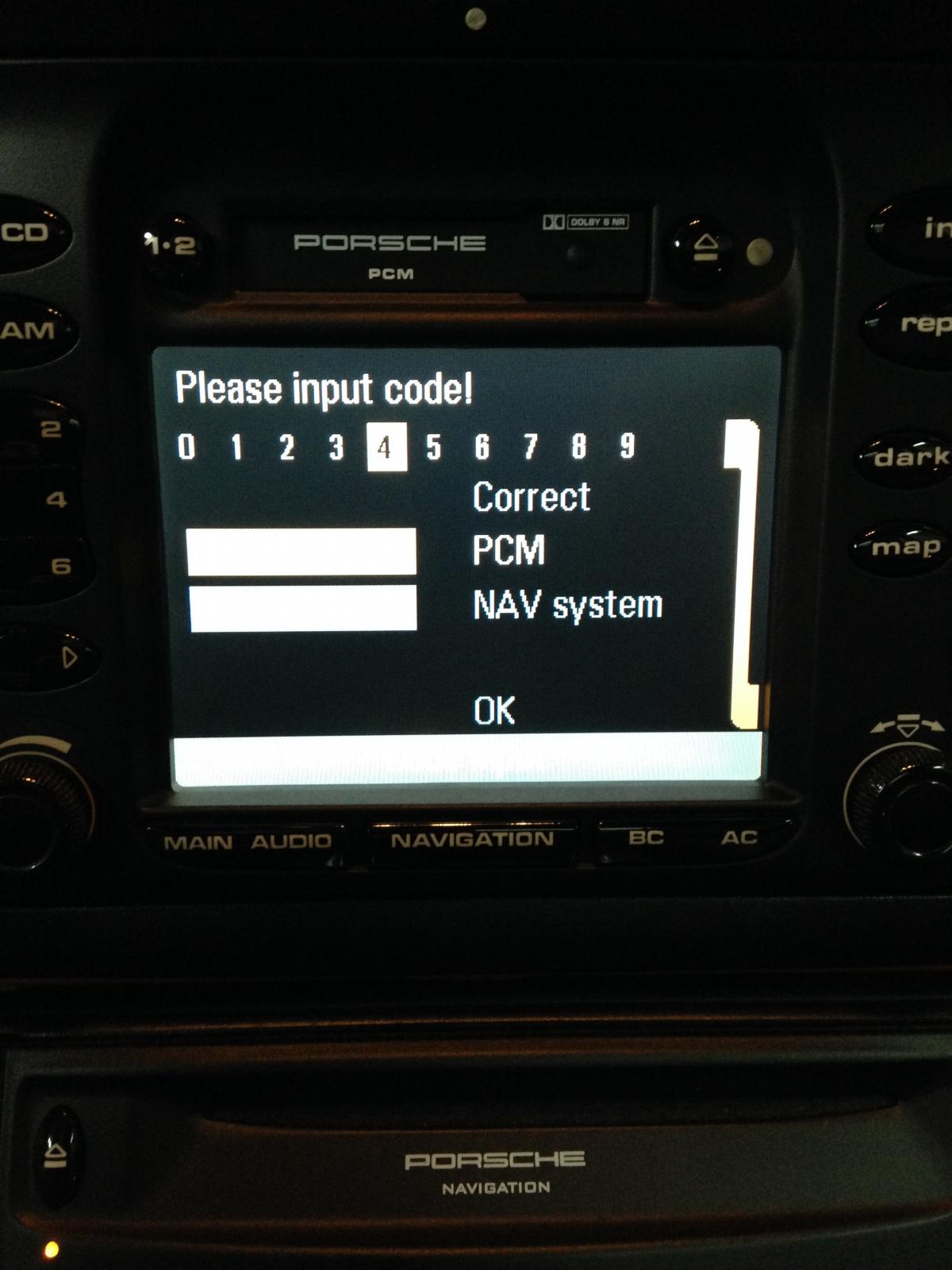

Thank you for the great DIY! Worked perfectly as advertised. It took me about one hour total. The beer will have to happen later this evening though!  :thumbup:
One problem to solve is now the PCM Code message on the PCM/NAV. I have to find the right code to enter.

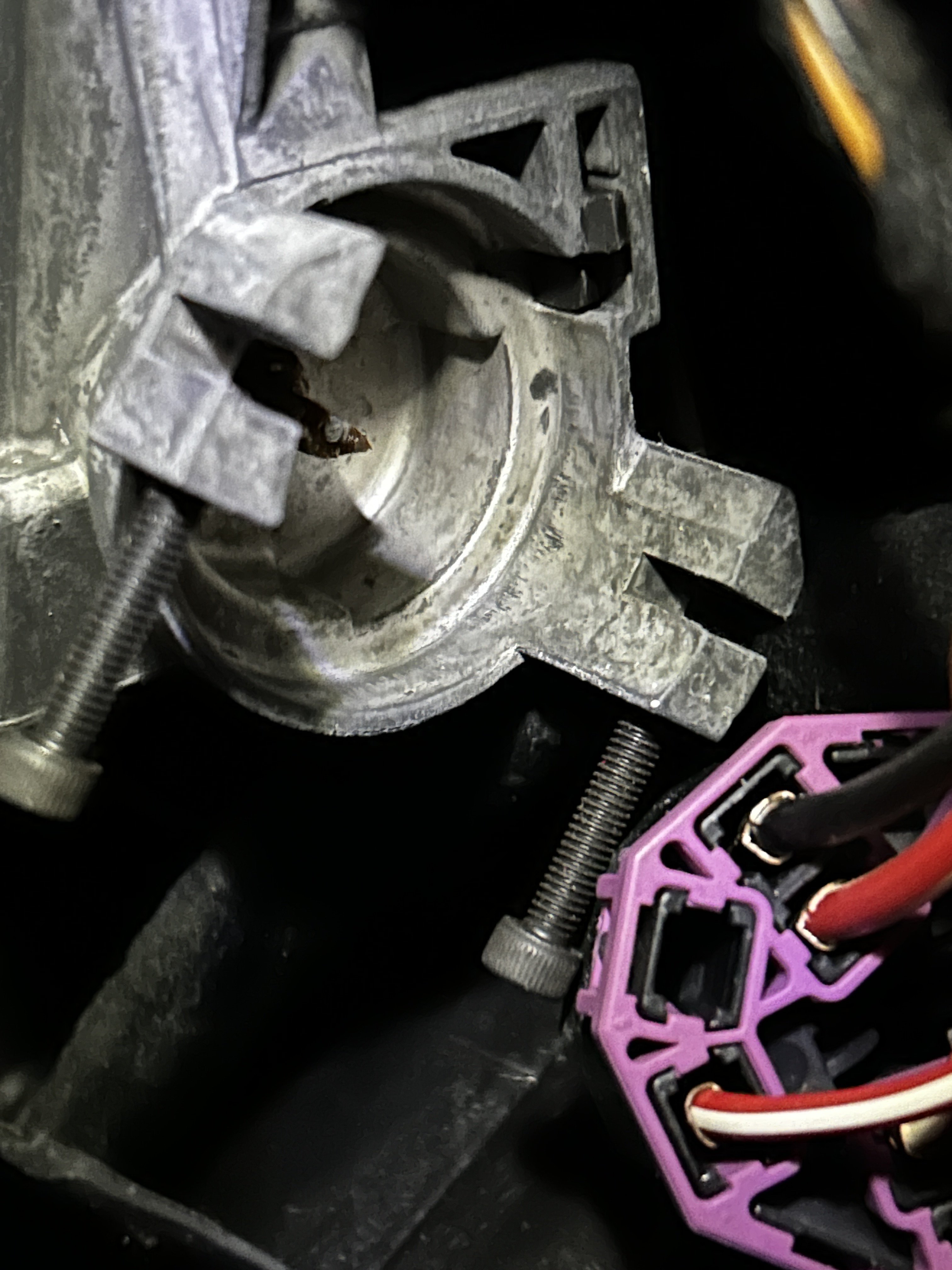

When I did mine recently, I discovered one of the grub screws had been replaced with a longer screw that allowed me to turn it loose with just my fingers.  After wrestling with a tiny screwdrive to loosem the other orignial grub screw, I replaced it also with a linger standard screw, which I sharpened the tip with grinder first.  Now I should be able to do it next time tool free, and MUCH easier.
