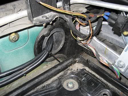

There is a large rubber plug on the fire wall behind the battery tray on the driver's side. On the interior it is just above the gas pedal. You can cut a small x in the plug and route your wires through. Be careful not to push the plug through.
Battery side
Above the gas pedal from inside the vehicle
I did the install a year or so ago and I have other photos. Let me know if you need assistance.

thanks, I went looking last night when i got home before seeing this but did not look behind the battery. There is the grommet to the left of the battery with a huge wire harness coming through, but I did not see or look for one behind the battery.

The wiring harness on the passenger side takes up most of the space in that grommet and I chose not to disturb the integrity thru the bulkhead there. The driver's side provides a simple routing of the cable to the back of the head unit. You will need the longer amp harness to connect to the brown plug behind the radio and make it up to your new amp.

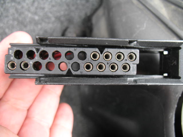

The PIN assignments for 996.645.311.00 are:
RL- 16
RL+ 6
RR- 15
RR+ 5
Here they are inserted into the harness

Here is the 996 diagram I used when I did the test. Same as what Kbrandsma says.
Left is 6 and 16, and 6 is the positive. Right is 15 and 5, and 5 is the positive. As I said before, the empty holes in the connector for the new correct round pins are numbered.
My plan was to use the extension that comes in the factory kit, but it has 4 male round pins and you need 4 female round pins to go into the amp connector. Cut the males off and crimp on the females. Part number for the females is 999-652-568-22. Cost me 25 cents each from the dealer last year. Just make sure you put the female pins in the correct holes the first time, because you can't remove them without the correct pin removal tool.
