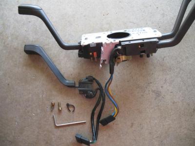

I bought the assembly last year for a guy because his tun signal lever would not return. Something wrong inside. So I remove the OBC stalk to use on another car for an OBC retrofit.
So if you replace the assembly because of the turn signals and you have OBC save the stalk.

I have some 3 stalk switch assemblies leftover from prior OBC retrofits. They are of course missing the OBC stalk. You can remove your OBC stalk and put it on a leftover. Free if you are local. Otherwise something to trade.

I ordered all parts from Sunset Porsche in Beaverton, Oregon. Here are the part numbers and the price I paid a little over a year ago.
1) 996-613-219-10
EWC 4 coulmn switch - $166.29
2) 999-650-513-40
Plug Socket (for wiring harness) - $2.86
3) 000-979-009
VW Wiring Set (5 of them) - $13.05
4) 993-552-573-01-01C
Steering Wheel Switch Cover (additional opening for 4th stalk on Left hand side) - $6.06

I just finished replacing the 4-stalk assembly in my '02 996TT so I thought I'd post a few comments about my experience.
  • Bought the Intermotor (Standard Motor Products) replacement from RockAuto; P/N: CBS2235 $201.79 plus tax/shipping.  Seemed to be the cheapest I could find on-line; no guarantees that it's the lowest, YMMV, yadda, yadda.  Interesting thing is, it turned out to be a GENUINE Porsche part!!  Had a Porsche quality control sticker with the Porsche P/N: 99661321910EWC.  It would appear that Intermotor supplies Porsche. Now, don't blame me if you order from RockAuto and it doesn't have the sticker!!  I am just relating what I received:)
  • Watched this Youtube video: https://www.youtube.com/watch?v=hux78ZoPcAI
  • WATCH the video, or something equivalent, before starting this project.  You do NOT want to figure this out on your own!
  • Time: Took me about 1.5 hours to disassemble and 2 hours reassemble=3.5 hours total.  I worked very slowly and carefully having never done this before.  I'd bet I could do this job completely in just over 1 hour next time (hope there isn't!!)
  • Tools:
  1. LONG T30 torx to remove airbag.  A short socket type T30 will NOT work; the torx head screws are recessed over an inch.
  2. Small standard blade to remove plugs covering airbag torx screw holes, airbag connector and turn signal wire harness connector.
  3. Small Phillips to remove the two screws holding the steering column cover in place.
  4. Medium Phillips to remove front 4 screws holding the front bezel and 2 screws holding the 'clock spring' in place.
  5. Tape for holding the 'clock spring' together while it's removed.
  6. 8mm socket or nutdriver for the turn signal holding clamp.
