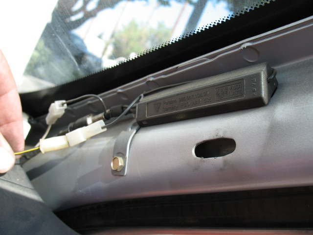

Aerial amplifier
It is on the windshield pillar. On a LHD it is on the right side. I think is is also on the right side on a RHD.
You need to remove the visor and the long black plastic trim that covers the pillar.
Great - Thank you, I will look tomorrow
Dave
Becareful removing the visor torx screws and putting them back. The screws are held in place by a jam nut that is very easy to strip.
