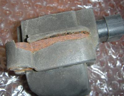

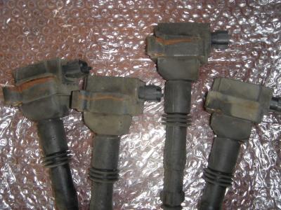

If they look like this, then replace them. Pics from Tim on boxa.net.
