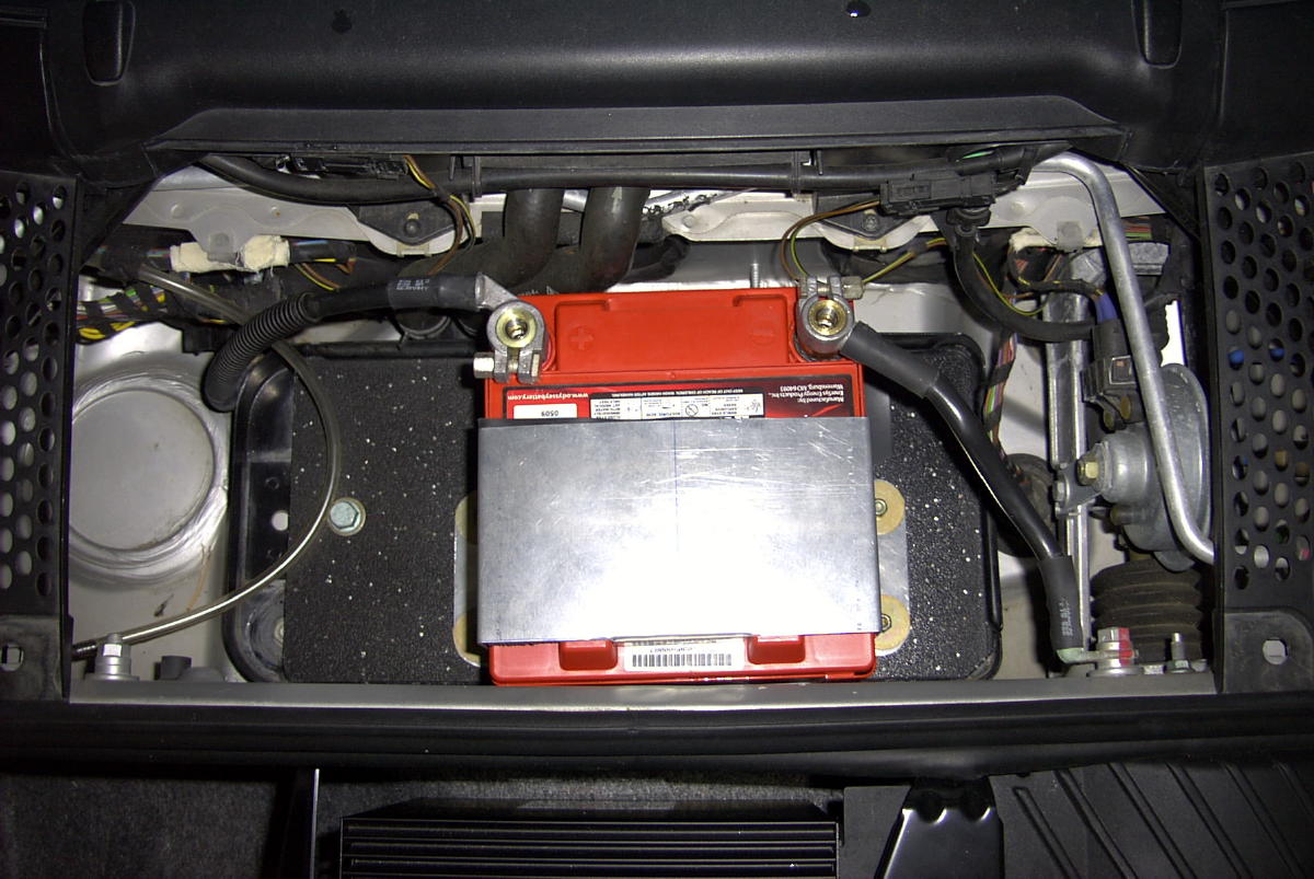

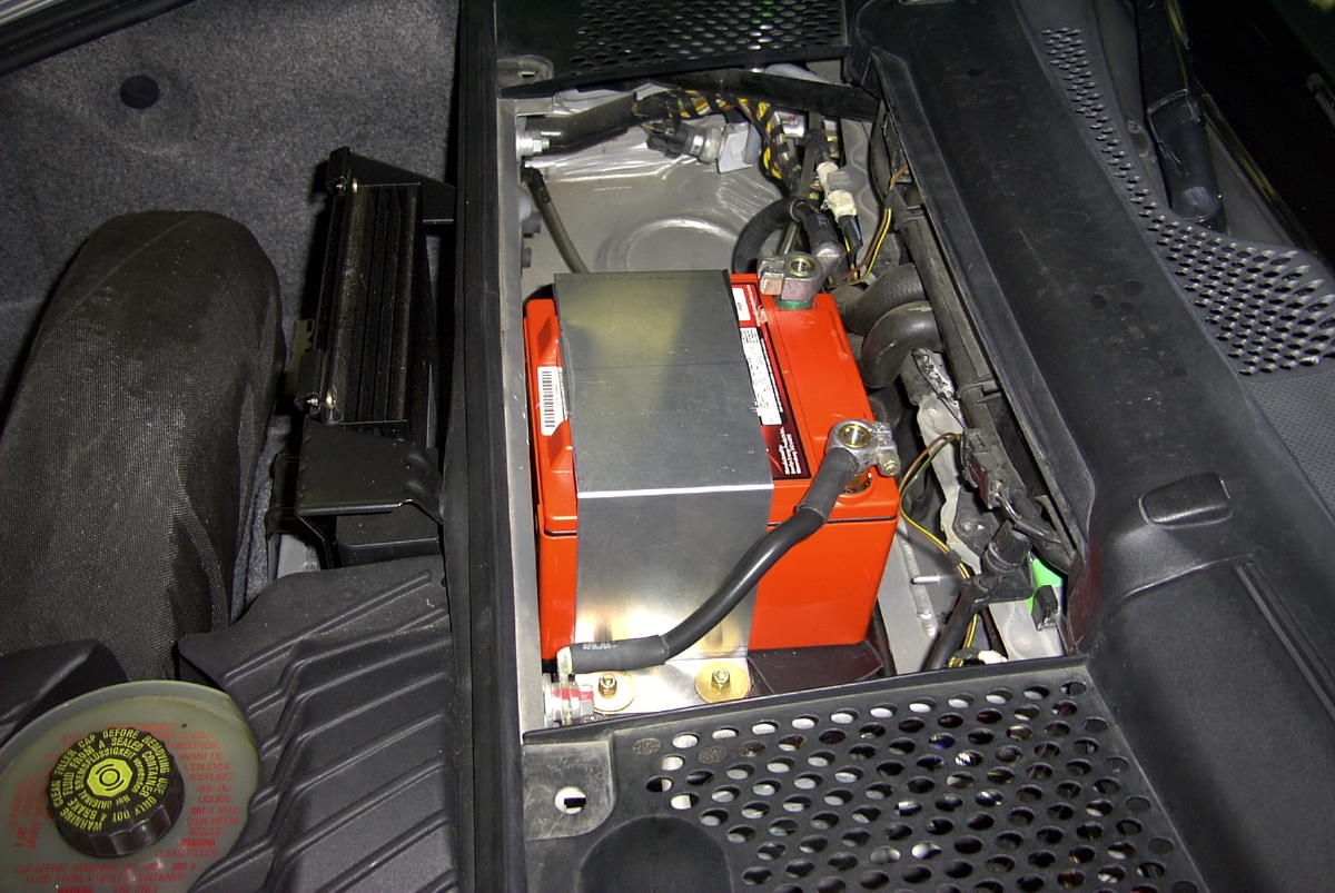

My car would not crank over after a 3 day hiatus from commuting so I installed a new battery in my 99 Boxster. I'm building an airplane and will shortly need a battery for it and thought I would get some experience with a lightweight Odyssey PC925MJT.
Expensive ~ $175 but small, and no venting. Called "Absorbed Glass Matt" or AGM
I bought a plastic cutting board in the kitchen supply department of Target, cut it to size and bolted the battery to the board using counter sunk machine screws from the underside and some bent up aluminum. The stock cables just reached but I might need to protect the positive lead where it is barely touching the metal battery tray.
http://www.odysseybatteries.com/battery/pc925mjt.htm
post-32107-1256616527_thumb.jpg NOT a porsche.

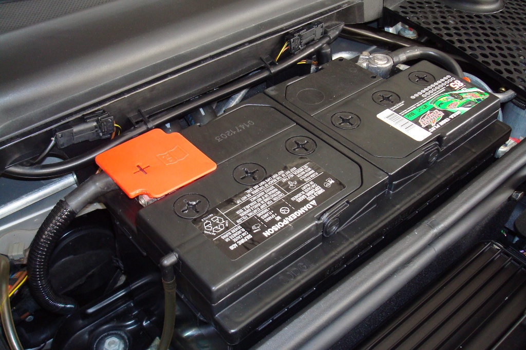

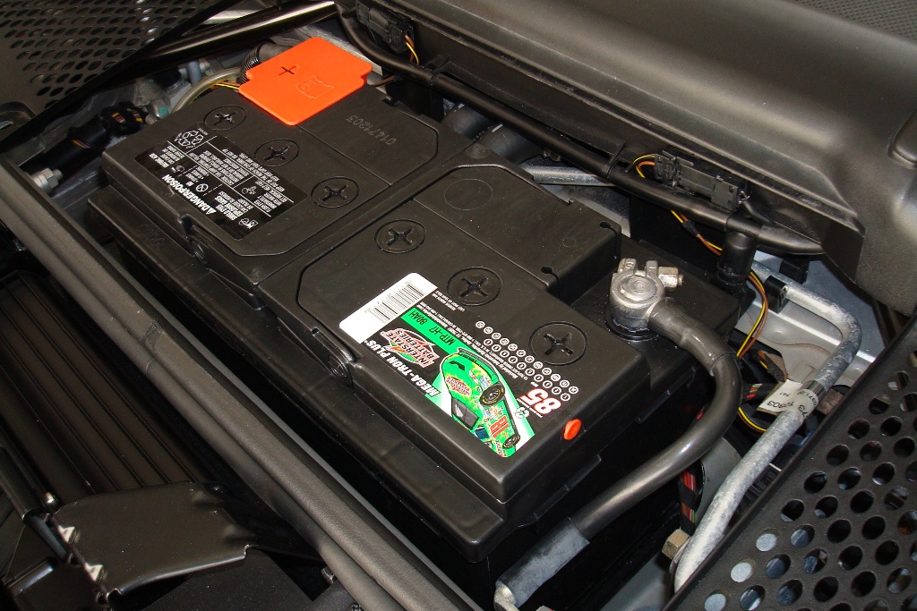

This is another vote for an Interstate MTP-H7, which I just installed in my 2003 Boxster S. I've had the car for 5 years and the dead Porsche/Moll battery was 6+ years old based on the date code. Not bad for a Porsche OE battery, from what I've heard. Anyway, the MTP-H7 was an exact replacement (see photos). Vent tube, hold-down position, perfect fit. Kinda looks OE, too. About $200; self-installed.

Purchased a 94R from WalMart for $77.00 for my 2001 C4 Cab, direct replacement for the Porsche battery that was in the car. The price was half of Auto Zone and other auto part stores. The battery is made by Johnson Controls with the side vent, same as the Moll battery from Porsche. Three years full replacement, then 84 months prorated. How do you beat that?
