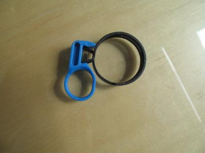

For the bottom oil separator clamp, there is this. I forget if it comes with the separator or you have to buy it as a separate item. The blue plastic thing compresses the clamp. Once the clamp is in position you pull the plastic thing away. I saw the mechanics at my dealership using it.
