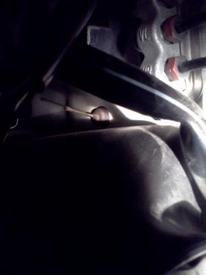

I had the same issue with my 2007 997 C4S. A closed trunk + dead battery = nightmare. The car was towed to RPMnorth here in Long Island, and the guys there knew exactly what to do since they are quite familiar with Porsches and the other European cars. They took the left (driver's side) front wheel off and the plastic covers from under the wheel well to expose the emergency trunk release cable. If you don't know exactly what to look for and have an untrained eye, you would never find it...or have an extremely difficult time locating it. Here are the pics.

My 997.1 TT has a plastic shield right below the cable in the picture above and instead of the looping cable in the picture ^, there's a yellow wire/cable (?) sticking out, is that it?

I finally found this post with photo -- I removed the wheel well panel and found the magic emergency pull cord. I thought I was in, however, upon pulling the wire, I got nothing!!!
