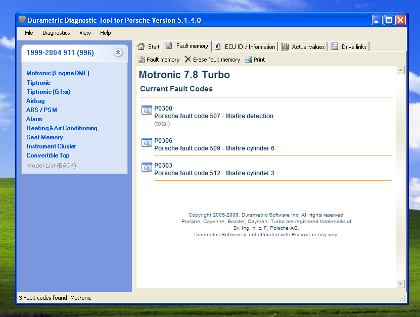

I have a 2003 996TT X50 that I drove up to Virginia for the 13 Hour race (unfortunately in an Integra, not in a Porsche :lol: ). After a blustery, rainy Saturday night, I packed up on Sunday morning and upon startup got a check engine light. Since it was not flashing (and I had no good options to have someone look at it) I drove cautiously back home to Atlanta and plugged in the Durametric. There was a misfire on cylinders 3 and 6.
I cleared the code and it has not yet reappeared. How concerned should I be? What could have caused a misfire on both "front" cylinders? I replaced plugs and coil packs about a month ago, but the car has probably 1,000 miles on it since then.
