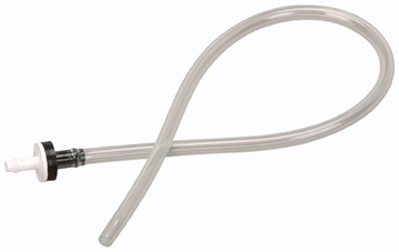

While you are at it....Change the brake fluid. Easy and really easy with these tools...All you really need is the tube with the valve.
Start with Passenger rear, outside, inside, then drivers rear, outside, inside, passenger front outside, inside, drivers front, outside, inside.
http://www.harborfreight.com/cpi/ctaf/disp...temnumber=37201
http://www.harborfreight.com/cpi/ctaf/disp...temnumber=98864
