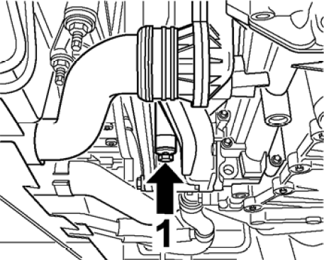

I would check the oil pressure relief valve.
Got it. So when you say check should I look for wear, leaks ??? Would you guys recommend a fair online source for parts.

Well the spring and or piston (on the valve) could be sticking or bad.
This was a (TSB corrected) problem on some 987's but I had not heard of it on a 997 yet.
This sure sounds the same if it only happens when the oil is cold.
