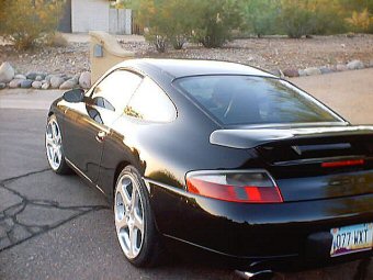

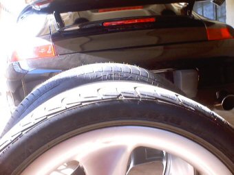

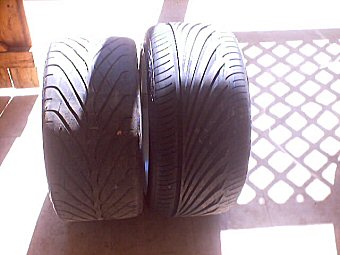

I run verdsteins and 295/30 rears with 235/35 front 305 fit and have heard 325 fit also but cannot attest to that.
WoW those look great! is your car lowered at all? how wide are your rear rims?
Thanks and No car is not lowered but the 19's fill in the wheel arch gap better without suspension changes. The rears could come down 1' more and the front 2" in my opinion. They are 67" rear offset and 50 something in the front. As you can tell by the original bridgestone's vs the verd tires that the verds have a larger sidewall and are not stiff which gives a nice ride.
Great job looks great... what rims, tires and sizes? Any rubbing up front at full lock right or left? I think like mine it needs to come down some but, that's another day.
Yeah I think its sitting up a little high, it looks like mine is higher then yours for some reason. They are 235/35/19 in the front and 295/30/19 in the rear and my wheels are also 11" wide in the rear and they do stick outside the fender just a hair. If I were to do it again I think I would go with a 10" rim in the rear but I do plan on getting a Turbo soon so I will just switch these wheels to it when I get it and they should fit perfect :D

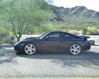

This picture is the 997 turbo rims with 235/35/19 front and 275/30/19 rear that I blieve is the stock set up for the 997 turbo. At least I think I saw it listed that way some place. I am certain of the 30 profile in the rear with the 35 in the front. I have worried about rubbing the wheel well skirt since a drag car I had before would pull that trick when on the gas. Watch for the wheel wells rim slicing the tire by checking tire and the wheel wells rim for deformation since that is your concern. I think my suspension is stiff enough but always checking is the best thing to do. None of us want a problem at speed.
From the looks the rears you have 2" gap which is ample room and from what I can tell the stock suspension is stiff compared to many cars I have driven although I have seen potholes the size of sink holes so always good to check periodically.
