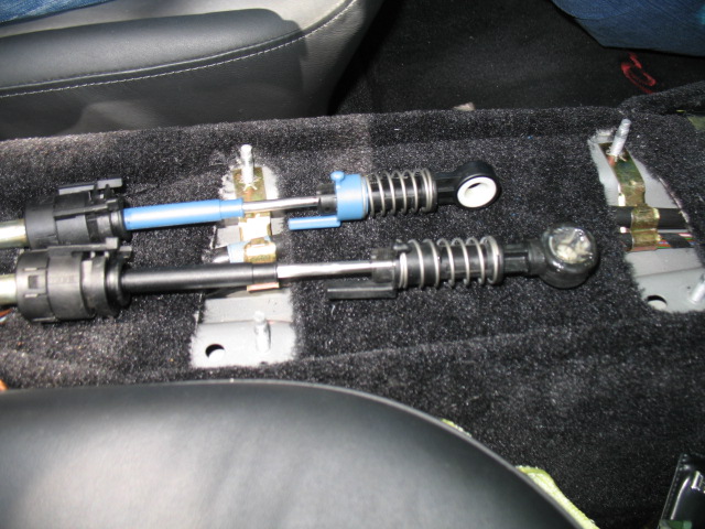

Tool Pants likely posted a pic a while back - try searching.
At the bottom of the shifter rod is a black ball socket - pry that off. That is the main shifter cable for gears 1 to 6.
Then disconnect the blue shifter rod (pin). This is the for the reverse cable..
Hi Loren,
Is this the pic you mentioned?
