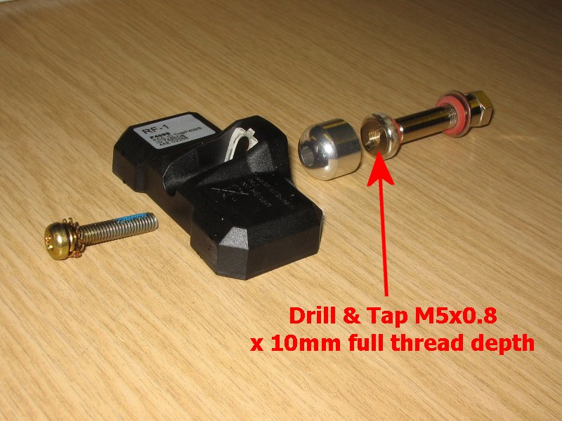

I thought I would just finish this off by saying that I went for the Orange TPMS. I had to make a modification to the valve stems, but Orange supplied a fitting kit to fit the sensors to the valves. Here is the mod:
I just need to mount the display, and hardwire it in, but so far it all looks good.
Thanks to member Timf for his help in pointing me in the right direction.
