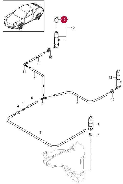

Well, not much for 997-2 service manuals yet.
From PET it almost looks like they can be removed by rotating them - perhaps 1/4 turn or so. Be careful to not force them.
On the 997-1 you had to remove the bumper cover and take the whole nozzle body off.

First remove head lights to gain better access to the nozzle opening.
Insert a small flat head screwdriver (with tape on the head to prevent damage to nozzle) into the opening in the nozzle head and pull the spray nozzle up and out (there is quite a suction on the nozzle so a second pair of hands is useful here to hold nozzle up from the stalk when it is up)
Hold the nozzle head at the top and disengage the catch on the spray nozzle with a very small (watchmakers) screwdriver. The nozzle head is released. Insert replacement nozzle into head (locks into place) and release nozzle, which returns to its original place.
Refit head lights

Eric's instructions are accurate, however I R&R 'd the nozzles without headlight removal. Used a small tool similar to an allen wrench with a 90 degree bend at the end to lift the nozzles. Hold on tight as Eric mentioned; there is indeed a strong spring retraction force. I clamped the nozzle off with a pair of plastic fuse-puller pliars to assist in removing the OEM chrome version. Once I figured out to lift the nozzle without complete bumper cover removal as directed by the dealer, the whole job took about 15 minutes...
