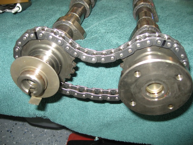

I went on your website. How did you know the spring was broken? I can't tell from the pictures.
You can tell right away just by touch. It is very loose. In this picture you can see the visual signs. Over time springs can become weak and break. Right now, as I wait out this cold weather, I'm trying to decide if I should go ahead and replace all of them, so there is an equal amount of presure across the board.

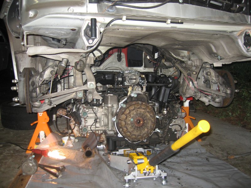

Updates...Its ALIVE!
I finally found the time to complete the build last week. This car has never performed as well as it does now.
More pictures and notes for all who are interested. As soon as I get the chance I will summarize everything that was done. The site will continue to grow as I gather my thoughts, but for now its packed full of plenty of info.

I like the use of the Harbor Freight Motorcycle jack to handle the removal/install. I have been eyeing that jack for some time and now I have another good reason to pick one up. Well done, well documented. Haven't seen the engine support at Harbor Freight that you used. I'm going to have to add that to the list for the next time I go tool shoppin'.
