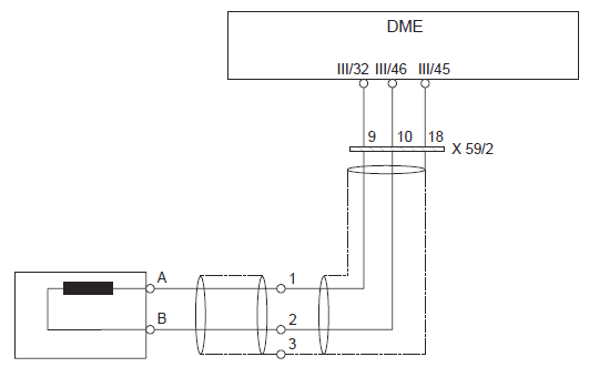

P0336 Engine Speed Sensor Signal – Open Circuit
The distance of the sensor is not adjustable.
From the service manual...
"The steel toothed ring is stamped from sheet steel. Take great care when installing and removing the flywheel, because force acting on the steel toothed ring can deform it, leading to a defective signal."
Connect ohmmeter connector part to rpm/crankshaft position sensor, pins 1 and 2.
Display at 20 °C: 0.8 – 1.0 ohms -- Not ok -- Replace rpm/crankshaft position sensor.
Connect ohmmeter connector part to rpm/crankshaft position sensor, pins 1 and 3.
Display: infinite ohms -- not ok -- Replace rpm/crankshaft position sensor.

hmmmmmmmmmmm... well they said they checked the wiring and also put a new sensor on it - only to draw the same code. so is it the flywheel? maybe it was banged during install?
With all due respect to the shop - how did they check the sensor? Per manual procedures as I listed above?
i asked if they checked the wiring, they said yes - then proceeded to fit a new sensor on it. even with the new sensor it triggered the same code.
so must it be wiring or the flywheel?
