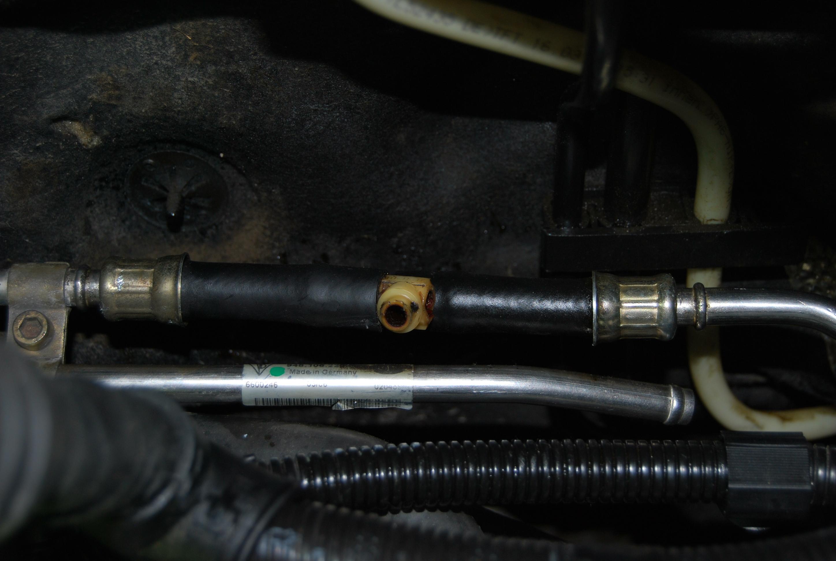

The photo posted above by "Faceman" is the T connecotr with Part# 955 106 323 50 which is really the problem maker.
Could you please inform if that is specific to Cayenne TURBO models or not? I need to know if Cayenne S models have this item in their engine and if anyone has really replaced that in his Cayenne S?

I just changed out my plastic coolant pipes for aluminum. Part of the kit is this plastic T into a vent hose at the back of the motor. Mine was broken and I could not find a single crack in my plastic coolant pipes.
This is a strange little T since it is plastic but connects two halves of a rubber hose with pressure crimped fittings onto steel lines. I almost replaced it with a metal one but it just did not make sense. Maybe, somehow, this little T is really the problem?!
You can see in the picture the gap in the rubber hose below the T. This is where it fits in. Notice the type of hose it is on either side of the T.

I think I have exactly the same problem you had. I removed all the plastic pipes plus the two connectors coming from top coolant pipe #3 and found no damage or cracks. Unless there is some hairline cracks but I lost coolant much quicker than that. Only thing I did find broken was the small white (used to be white) T-connector pipe in your picture - and it was really brittle when I tried to remove it it just snapped off on the one side.

Below are the PET part numbers for the failing plastic 'T' water hose fittings. There does not seem to be any difference between USA, CANADA or ROW vehicles regarding these fittings.
Turbo V8 has 2 water hose fittings installed.
Part numbers are:
955 106 323 50
948 106 035 51 (this one connects to the water return line for the cooling of the turbo chargers).
The PET shows that the normally aspirated V8 has only a 955 106 323 00 water hose fitting installed but apparently is not a T piece so may not be an issue.

That broken white plastic piece is some sort of vent or vaccuum line possibly related to the PCV system. It is NOT related to the cooling system. It was broken on mine too. I just put a new 90 degree t-fitting in to replace the old one. Thread a wood screw into the broken piece of the barb that is stuck inside the rubber hose, that should help you pull out the old pieces.
I could tell that mine had been broken for some itme as there was a lot of dirt around the area. It is now fixed, and honestly I don't notice a difference with how the car runs.

As promised, here is a picture of both T's and their respective rubber hoses. My leak occured when the bottom T broke off of the hose to the left. The hose on the bottom right broke as I was removing it.

I looked at the T-pipe I replaced and it had signs of water leakage and build-up but not a major break or crack. I took it off and its real soft, to the point where you can scratch a groove in it with your finger nail and the ridges for the hose connections are a bit smooth. Im going to replace it but I am afraid that it may not be the main source of my problem.
My thoughts are maybe pressure from the high RPMS and the soft, smooth ridges allowed coolant to push past the fittings and clamps???

Unless you like doing thankless jobs and risking damage to the starter and transmission.. REPLACE the plastic crap with aluminum. Order a new T fitting, and if you want metal (I'd suggest stainless or copper) - take the new one to Home Depot, and ask the plumbing department sales dude to find you something that will "work" - then assemble it with teflon tape on the threaded bits (it will likely be 4 pieces fit together - a T and 3 barbed fittings), put it on and forgeddaboutit.

I addressed this tonight and there are no T pieces at all on the Cayenne S - at least not on my one. There are obviously 3 rubber hoses connected to the main coolant lines across the top of the block. One simply goes to the coolant filler and the other 2 disappear down below where they join METAL pipes which run all the way to the interior which I assume are the internal heater feed and return. These hoses disappear towards the passenger side but remember im in the UK so RHD.

My father called our local Porsche dealership here in the UK this morning to check the part number given above for the Cayenne S. They said this is a rubber joiner hose with no branches off of it (which makes sense as there is no additional feed required with no turbo). They also said they havent had any Cayenne S's in with this as a problem. The cracked 'T' piece issue seems to be a Cayenne Turbo issue. They dont keep this rubber joiner in stock as they never need it. The main coolant pipes however they keep a stock of at all times which I think tells a story in itself. If I get time after work tonight I will fire the car up and see if the problem has been resolved with the new metal hoses.

Your dealer is correct. It's a formed hose. No plastic T on the S model.
