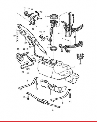

Apparently that seal up top is attached to the tank (not the neck).....wish I had a parts page to better visualize.

Can you tell what seal they are talking about?
OK....the best guess is that it's a malfunctioning seal is located where the neck inserts into the tank......and unfortunately, that seal is apparently inside the tank.......worse yet, it is 'part of' the tank. The assumption is that the neck inserts to this internal seal.
The rings illustrated as 16 & 17 are not seals.......17 is actully a soft foam, 16 is basically a metal washer.
None of this can be accessed from up top.....you can barely reach in and with a couple fingers touch the foam ring.
