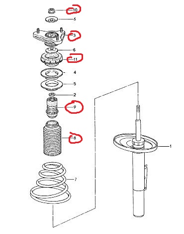

Oh ROW M030 suspension that's been sitting on my garage floor for the past six months... almost time to dust you off and install you! :)
About the time I was going to start my install, a CEL problem plagued me for the next several months. Now that it appears my problem is fixed, it's finally time to get back to what I was doing!
So far, ordering what appears to be wear items on the struts. Pretty much anything rubber. This is what I have so far:
996-343-301-02 rubber bump stop front strut
996-343-505-00 protection boot for front shock
996-343-515-05 front shock absorber mount
900-380-012-01 front/rear shock absorber mounting nut
987-333-059-00 rear shock absorber mount
900-380-005-01 rear shock absorber mounting nut
999-084-447-01 front shock absorber mounting nut
997-343-018-01 shock mount flange for front shock absorber
986-333-285-01 rear shock mount seal
986-333-301-01 rear shock rubber buffer
986-333-505-01 rear shock bellows
I also added the nuts, but, since they don't stretch like bolts do, should I just skip them?
Not looking at replacing the control arms at this time. But, anything else I should be looking at under there?
post-73203-0-63417700-1339027453_thumb.j
post-73203-0-55624900-1339027464_thumb.j
