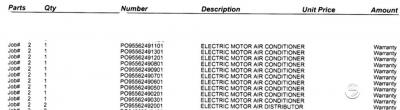

Mine had the same issues and the whole dash was removed to change all 12 (yes 12), servo motors.
No idea what it costs as mine was done under CPO warranty.
Good news is that once the servos were changed, the a/c system is perfectly quiet.

Mine had the same issues and the whole dash was removed to change all 9 (yes 9), servo motors.
