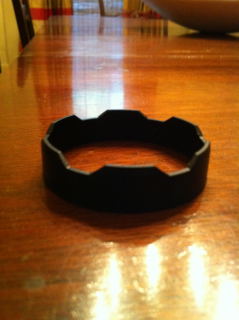

UPDATE - after my 11/29 post above, had a new problem - was trying to keep the gas level near empty before bringing it in for a new fuel neck. Had to add 2 gal. because I was on reserve and when I started the car, the fuel gauge needle had not moved. Turned car off and back on again, no movement. Had to add 3 more gallons to get needle to move. Since then, the fuel neck has been replaced and I had my 1st chance today to add 1/2 tank w/ no overflows, no problems. So far so good. When fueling, it did seem like the nozzle did not go in as far as it use to. Maybe my imagination, maybe a change with the new fuel neck?? See attached pic for a piece that was not used. Apparently it's a piece used for CA. emissions that's required there.

Last update-ran tank to empty and refueled. No problems, no overflow, no premature fuel nozzle shut off. The only difference I noticed is that the gas nozzle now sicks out of the fuel neck about 4 inches when fueling. Does not even reach to the vapor barrier found on the nozzles.
