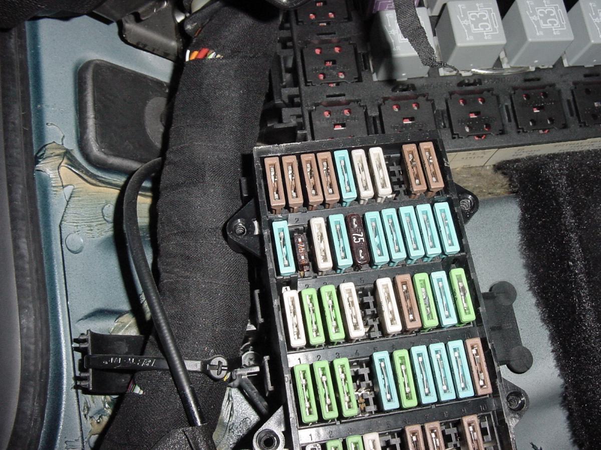

On a side note, I just found out yesterday that the rear spoiler is not working, could this be just a fuse, do you know how I can check easily?
Thanks again

Rear spoiler fuse is D7 (15A) on the kickpanel - lower left.
Thanks Loren

If that fuse (D7) is good, check the two relays in the rear trunk (i.e., on the left side of the trunk, behind the carpeted trim panel).
In the top row of relays in that location, the third relay (from the rear of the car) is for spoiler extension (relay #3). Just below it (in the bottom row), relay #9 is for spoiler retraction.
Funny I did not know until I posted this pic that there were numbers under the fuses :rolleyes:
I gather that the fourth bank from the top is D as I do not see letters, and the fuse is good.
I also found the little switch that manually raises and lowers the spoiler, which does work.
So I guess it is time to check the trunk to figure out the relays.
Now since there is a relay for each direction Up & Down, should I try raising my spoiler and see if it retracts?
BTW Maurice, when you say the left side do you mean the drivers side? Thanks

The left side is the driver's side (except in the UK, where the driver's side is on the right :eek: ). So, when you are standing behind the car, looking into the rear trunk, that relay tray is on the left, behind the carpeted trim.
Here is a photo where you can actually see the numbers above each row of fuses:
post-6627-0-11080600-1336190987_thumb.jp
(Click on the photo for a better look).
