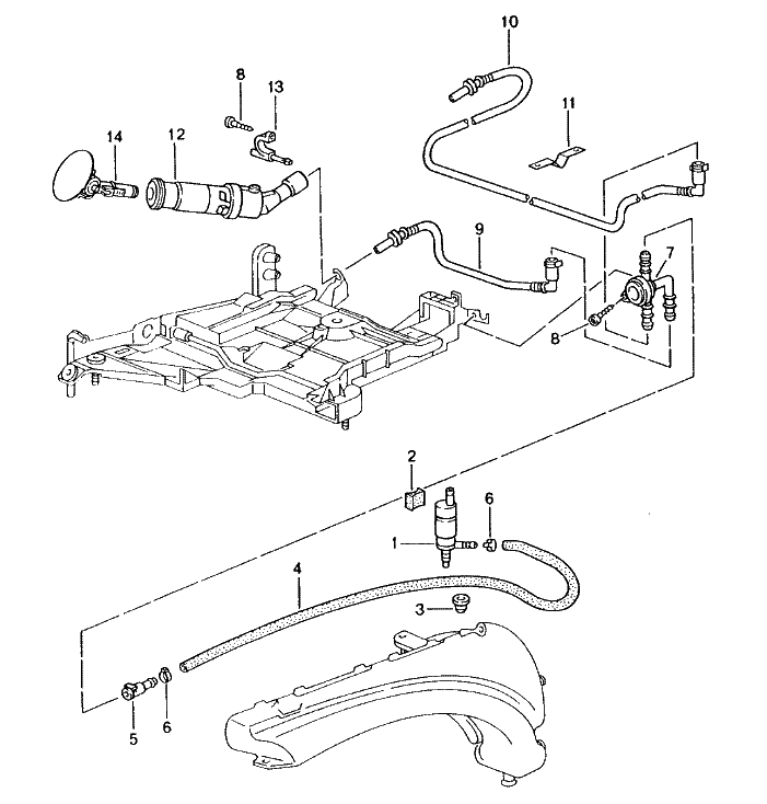

OK...it was still leaking so yesterday I openend the whole thing...and while opening it I broke part of the headlight mounting plate. I don't understand how it happenend, I followed the descriptions I found on the internet. Maybe I wasn't very careful enough :(. But okay, no big deal, I'll replace it with a new one. I then examined the headlight washer nozzle: there must be a very small leak at one of the openings, so I guess I'll have to replace the nozzle also. Looks very straightforward.
But after having removed the headlight, I noticed a cable lying around (see pictures below). I don't see where this cable should be fitted. Anybody knows where it must be attached ? I don't find anything about this cable in the workshop manual.
Thanks.
