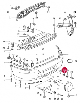

Sorry in advance but this is a newbie question. I tried searching but didn't find my answer so thought I'd make a quick post!
My rear numberplate area has 2 square-shaped holes in the bumper. I am completely clueless as to how I would screw a numberplate there. The previous one had some weird adhesive attaching the plate on (and it came off very easily). Happy to post a pic if need be. Any help is very greatly appreciated :)

You will need two of the expander nuts 999.507.040.40 (US MSRP $0.87 each)
Thanks a lot Loren. Wish they were that cheap in Australia! I paid total of $AU7.20 for 2!! Thanks once again for the prompt reply - really appreciate it.
