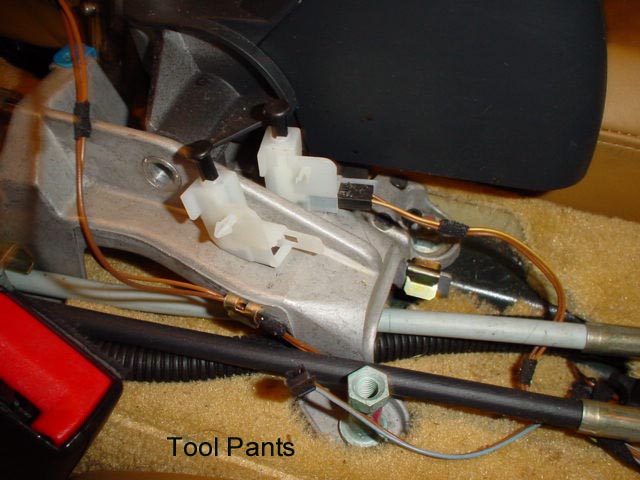

If you replace it, it is only a $5 part. But you have to remove the entire console to get to it. You don't have to unto the handbrake assembly. Just lift up the handbrake, you should be able to find the switch underneath the brake handle - just pull out the connector, replace the switch and put the connector back in. The switch is not visible in the picture.

i purchased the microswitch from a local porsche dealer. i removed the anchoring screws from the center console, lifted and shifted the entire assembly to the right; exposing the handbrake assembly.
the microswitch is clearly visible. you have to pry the switch out (a flat head screw driver helps) and remove the wiring.
replacing the new microswitch takes a bit more time as you have to negotiate the plastic pin/receiving hole.
the total time expended on this task was approx 35 minutes.
