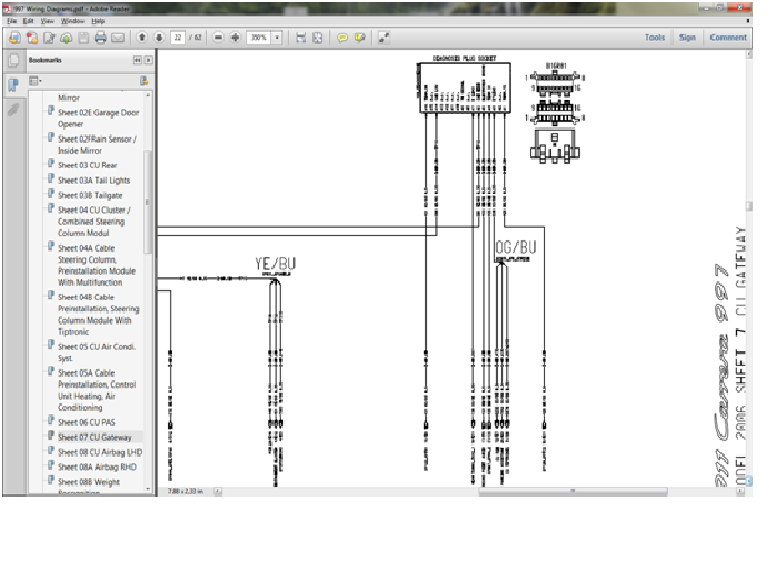

I am struggling to work out where the OG/BU (Orange/Blue) wire from the Park Assist Control unit runs to. The wire runs from the B3 Pin which is labelled "Diagnosis" in the park assist control unit to something called "SP035_SPK_STRICH". It joins at this point and goes onto the "Diagnosis Plug Socket" (the A3 Pin which is labelled k-lead). I believe the wire needs to be connected to the PCM but not sure. Has anyone any idea?
Attached is the wiring diagram for this area. Apologies but the picture is not clear at all, it is on Sheet 7 CU Gateway of a 997.1 Wiring PDF.

I thought the Diagnostic socket was where you plug in a Durametric lead (just under the glove box, passenger side RHD model), it didn't feel right, but we tried to splice it into a Orange/Blue wire coming out of the back of the "Diagnostic socket" and managed to lose the instrument cluster (went completely dead), we had to remove that connection, and the cluster came back on.
Am I completely in the wrong place?
