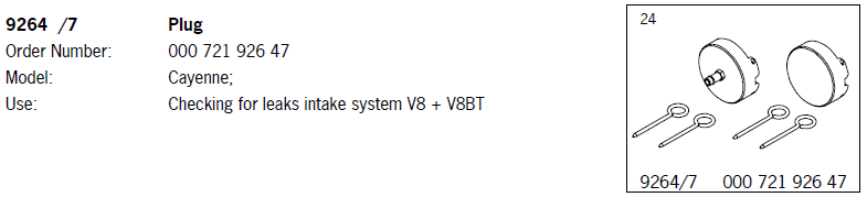

There is a factory tool for checking for boost leaks. Its basically two metal plates that fasten to the intake pipes with locking pins similar to what the air box uses, one plate for for each side. One of the plates has a tire air valve that you can put pressurized air into the intake system. If you have a leak you can hear air hissing out of somewhere. I'm not sure where you would find this tool except for at a dealer.
Yep thats them pictured below.

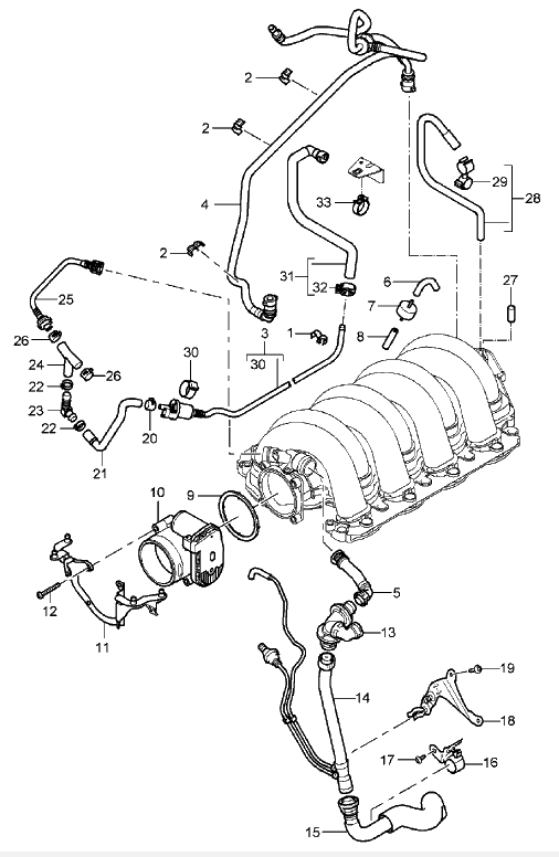

Intake distributor... do you have a diagram that shows where this is? If you mean the y-pipe in front of the throttle body I replaced that o-ring as well when I did the boost sensor replacement. No cracks in it that I could see. It has to be before the throttle body in order to throw this code right?

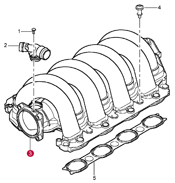

Loren, this does not look like the intake distributor for a 2004 Cayenne Turbo 4.5 liter...its missing a few runners. ;)

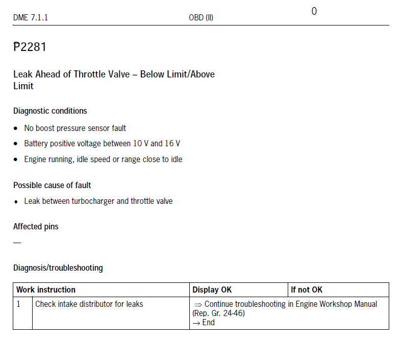

Also, since this code is for a leak before the throttle body could it still be the intake distributor after it?
Thanks Loren! I have not messed with the intake distributor in any way so it would be odd to have a leak there... also, I do notice I can get full boost of .8+ with my EVO tune, but for some reason I still get the code. Even though it says the leak is before the throttle body do you still think it could be the intake distributor? Could any sensor (other than the boost pressure which I already replaced) cause this DTC? Thanks
P.S. The Throttle valve listed in the description for my DTC is the part #10 in the diagram above right?

Okay, you will not believe this one.... first, I have to say I finally found the leak after months of guessing and the dealer not finding it on multiple visits. Second, I hate to say it Loren but you were wrong on the intake distributor... it is actually part # 955-110-046-00 and is the Y-pipe in front of the throttle body according to my PET catalog listing. Now here is the funny/scary part, the diagnosis/troubleshooting says to check the intake distributor for leaks... so....
Intake Distributor
I bought the Porsche test tool mentioned above (I won't mention how much I had to pay!) and went to Sears and bought a compressor with built in regulator. It took me about an hour to hook everything up but on the first shot of pressurizing the system I found the leak... drum roll please...
IT WAS THE **** INTAKE DISTRIBUTOR!!!!!!!!!!!!!!!!!!!!!!!!!!!!!!
Now why Porsche could not determine this when it is mentioned in the service manual is beyond me. What is even more interesting is that after replacing all the o-rings and one of the boost pipes and finding nothing else visually wrong it was the boost test that finally showed it. Believe it or not but it was the seam where the two plastic halves that make up the intake distributor in the front part where the V section is that was leaking. No way to see it visually, but boy could you feel the air pouring out of the seam when you pressurized the system.
