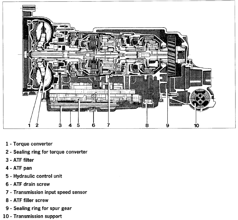

5.) Where can I get the schematic (like CAD drawing) on the TIP?

1. and 2. and 3. Two - ATF for transmission portion and Gear Oil for the differential section.
See also DIY Tiptronic Transmission Service
4. Transmission (ATF): Filling capacity = 9.5 liters; Change capacity = 4.0 liters
Differential (75W-90 gear oil): 0.9 liters
5.

Hi Loren: I am finally at a point, almost after 16 months, ready to get my baby back on the road. I found a used TIP with only 35K miles. I paid $2250. It is to arrive tomorrow and I was told that the TIP is in excellent condition. I guess I will find that out after it arrives. The TIP (A86.05) is for 2.7 L - 2002 yr. This TIP is shipped without any oil inside it. Now, I definitely need your help to get the oil, etc. Please let me know what (how many types), which (brand), how much (quantity wise), etc. of oil I need to re-fill the TIP? I will appreciate if you will itemize the items (oil, filter, etc.) . I am excited and can't wait to get back on the road. :drive: Thanks.
as Loren mentioned on earlier post the quantity is 9.5 liters if transmission is empty.
type : ESSO LT 71141 ( my experience is goldish in color )
how many types you can use with ZF transmission : jury still out and for a long time
Porsche Dealer : $18/liter last time I paid
and you have to take your own container or they sell fluid in a 20 liter container.
VW dealer : part # G052162A2 (sold in quarts) $16-$19
differtnial fluid : manual suggest oil type: Hypoid transmisson oil, Burmah-Oil, SAF-AG 4/1016
fill capacity: approx. 0.8 Liter (check for TSB might have been change to 0.9 Liter as Loren mentioned)
can't remember what I paid (Dealer) for it but somewhere around $30 (I hope I'm mistaken)
if you changing the filter (recommended) as well with the gasket around $35-$45
