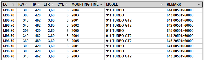

I'm sure this debate will rage forever, but it is my understanding that the standard Turbo in all model years from 01 to 05 was 420bhp.  The X50 kit was available as an option, which raised the power to 450bhp.  In 2005, it was available in standard (420) and Turbo S (450) models.  The S had ceramic brakes and other goodies.  The GT2 was 462bhp for MY2001-2004 and 489bhp for MY2005.  That's my interpretation from the UK brochures and Loren's chart above.
