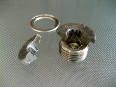

How to remove stripped drain plug?

I had  the same issue with the drain plug and also stripped O2 Sensor. I went to local hardware store, purchased a 5/8"-11/4" pipe wrench. It has 5 rows of sharks teeth and can muster all the torque you can put into it. Sprayed blastoff on the O2 sensor, let it soak over night and came off without incident. The drain plug just required the pipe wrench.
  • 5 years later...
Thank you for the tip to cut the tip off the #5 5 screw extractor and work it in slowly.  Worked like a charm, especially when coupled with my pipe wrench to break the over torque I put on the plu….  I had started drilling a hole in the plug to get the full tool in there but thought better of that plan when it seemed extractor was just drilling a bigger hole in plug and went with yours plan.
