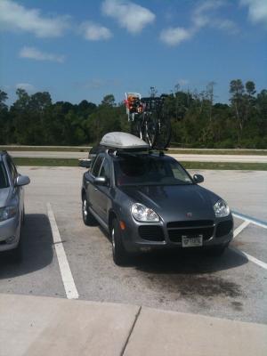

BTW - Enclosed is a picture of my CTT on my recent return from Florida back to NYC. Amazing how people get out of the left lane when you approach them at 100 mph with a roof full of bikes/carrier. Jethro of the Beverly Hillbilly's would have been proud
