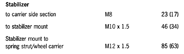

Does anyone know the torque value for the rear sway bar drop links or where I might find them?I have a 2003 Boxster
