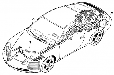

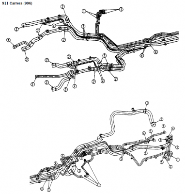

I guess you could have hose damage in the front and rear - separate hoses.
Here is a cooling diagram - as you can see the coolant pipes run down the center of the car.
and hose clamp locations.
