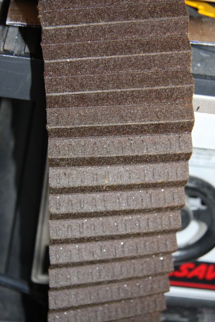

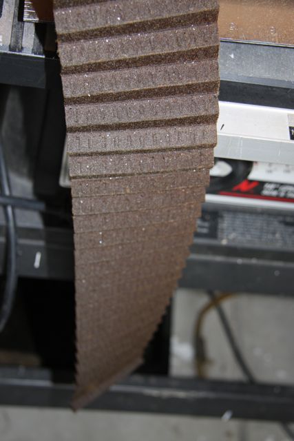

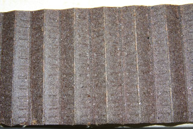

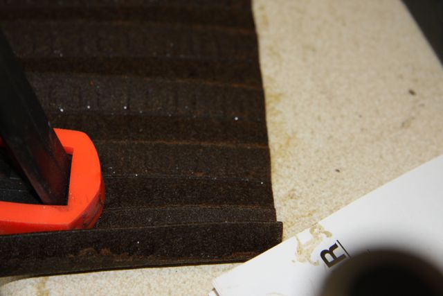

So I cut open the filter and this is what I found... I did take a good magnet to them and they are ferrous. Could this just be the filter doing its job? The last time the oil was changed was 6k miles ago.
I would be concerned about that amount of debris in the filter, especially as the bits are ferrous. First step would be to pull the sump and have a look. While the block and heads are alloy, there are several possible sources (rods, cams, crank, oil pump, and the IMS) for ferrous metal.
+1 Worry!

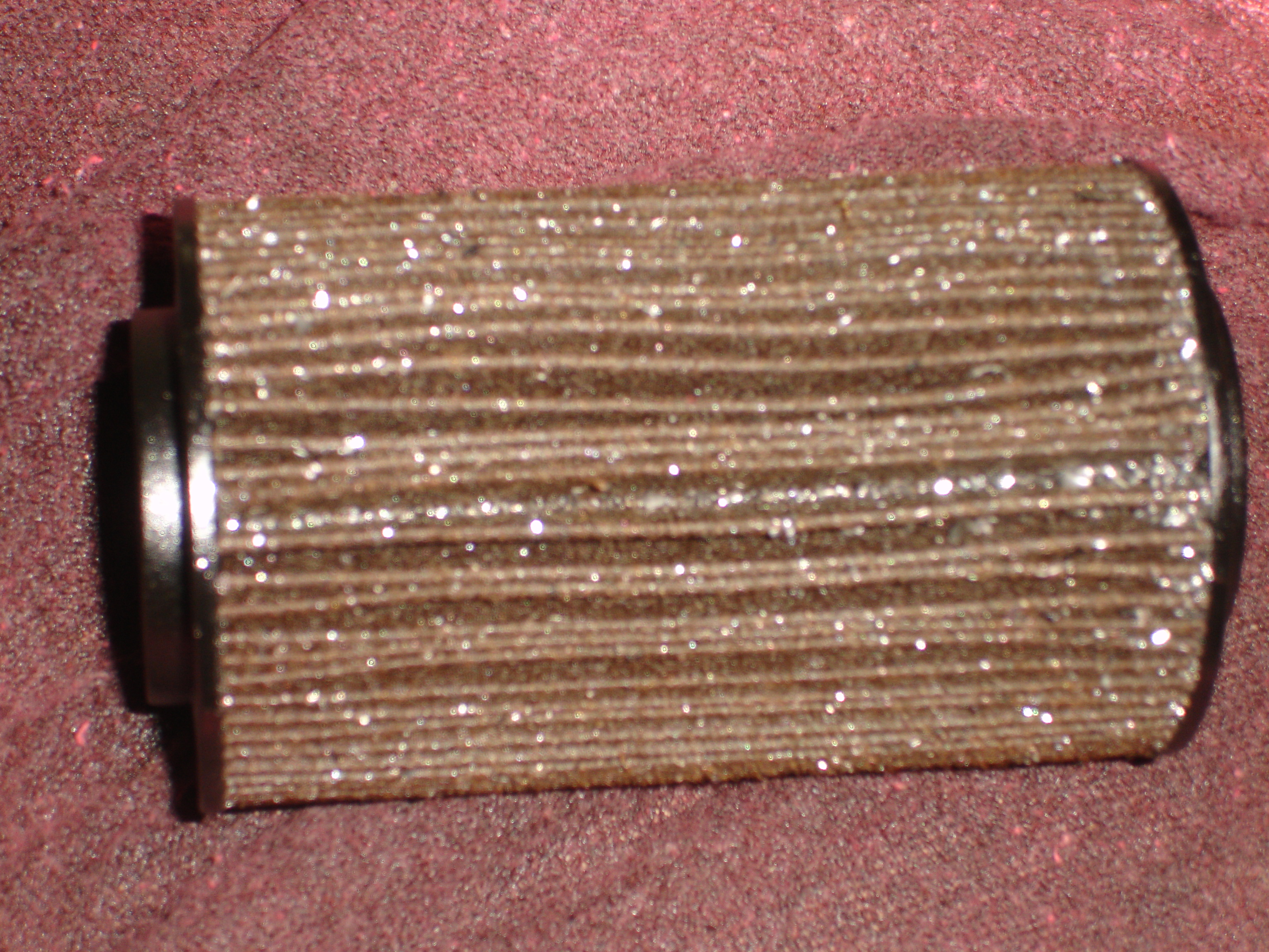

Metal in filter is bad, anyway you slice it. I have the filter from our IMS failure here on my bench, I will be photographing it tonight for our upcoming article. I'll see if I can post some pics...
-Wayne
I posted those photos as promised, in my Intermediate Shaft Bearing article: http://www.pelicanparts.com/techarticles/Boxster_Tech/14-ENGINE-Intermediate_Shaft_Bearing/14-ENGINE-Intermediate_Shaft_Bearing.htm Check them out and see how they compare to yours...

I agree. If there is that much stuff in the filter, there is probably more in the sump. Take a look at what my sump looked like in the article link I just posted. Pretty nasty!
