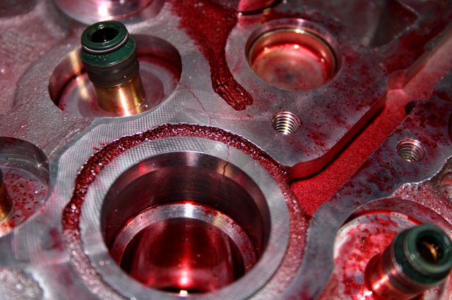

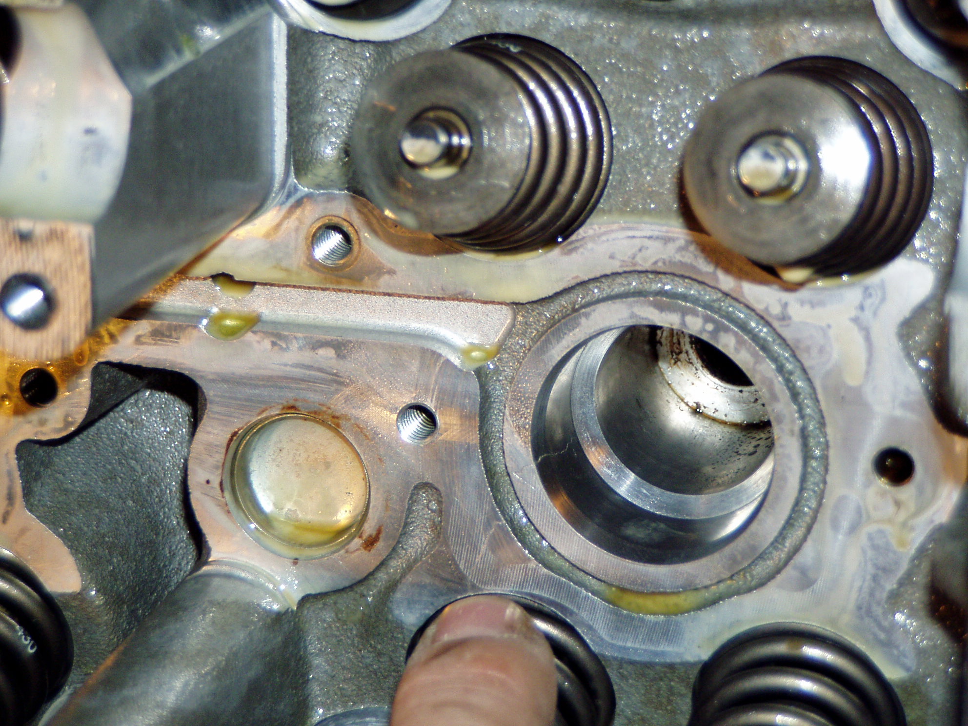

Had my 996 at an Indy who incorrectly diagnosed me with Oil Cooler broken. Replaced it without change in intermix. Wasnt going to spend the $ for new engine in this vehicle. Didnt identify the crack until I had the engine out and removed the spark plug tube for cylinder #1, then the crack was visible in the base of the recess. Unfortunately for me after having cylinder head 1-3 repaired found additional crack in Head 4-6. Thankfully hadnt put engine back in car. These cracks are visible to naked eye. And by note mine had a negative compression test as well. I have some nice pics of my crack if you're interested.
Tim
Found my cracked head after I checked the oil cooler and it was OK. Then dropped the engine and just started taking off the heads. The crack was readily visible once the lifter rack was out. Probably could have seen it sooner if I had know where to look. They are most common on the inner exhaust valve seat on cylinder #1 (or cylinder #6 which is basically them same area of the castings). Here are some pics of mine and another owners heads cracked in the exact same spot, same at Tim's. I also saw another owner's car that had a pin hole in the head that he only found with the head off and pressure tested it.
These are great pictures. Thanks.
