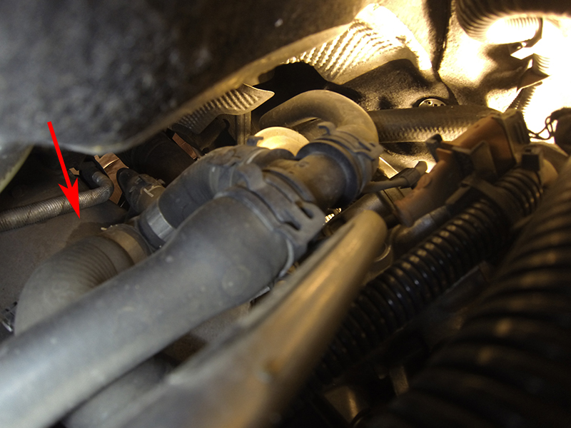

Thanks – just to note however I only implemented it myself; it was originally someone else’s idea (Jimi, I assume). But as an epilogue to that whole saga, I checked the drive shaft support the other day and it is like the day I installed it 10,000 kms ago. No driveline vibrations or issues so far. But as this thread started with my leaving on a +7000 km drive, ironically I have to make the same drive again, under different circumstances this time, and I am probably going to leave it as is, so it will be put to the test once again. And as an epilogue for the window cable problem, I did subsequently order a kit similar to the one you showed Pkcayenne (except from Okzam), and it installed with no problems and works well. So we’ll see what adventures are in store for the CTT this time, as I have a coolant leak (passenger side smell, only when running, no drips to be found but lost a litre in 3 weeks). Strapped my GoPro to a stick and monitoring on my phone I looked at the T’s and they seem OK (and the coolant pipes have been done), although there is some dampness maybe on the block under them. That might lead to some interesting posts!
Other than that I probably won’t get the torque converter seal leak fixed before I go in 4 weeks; I still have the bell housing catheterized, with a hose running from the hole where it drips through to a container. Still 4 mls per day, so I we’ll see if it makes it! Found a place to do the work but after Lewis’s nightmare I am reticent about having it done close to the leaving date.

If your going to have the engine dropped for the seal make sure you got some metal coolant T's made up and replace those rubbish plastic ones.
Also do the engine crankshaft seal like I did, its right there and god would you be pissed if later on the engine started leaking out the bell housing.
Safe trip.
Thanks Lewis; I probably won’t do it until I get back, but would definitely do the rear main seal as well. Not sure if it is easier to do the T’s with the transmission out (I think they can do the seals with just the tranny removed), might have to go in over the top anyway, but I am going to order the metal T’s and get it done. I was hoping taking just the transmission out would make access to those waste gates easier, but looking at it from under there, I don’t think it will.
